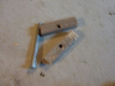

Step 4: Steering
I put two pieces of wood, each with a hole in the middle as my steering. Then i drilled a hole vertically in a piece of 2x2" and put it together with a bolt. I then secured it to the base.
