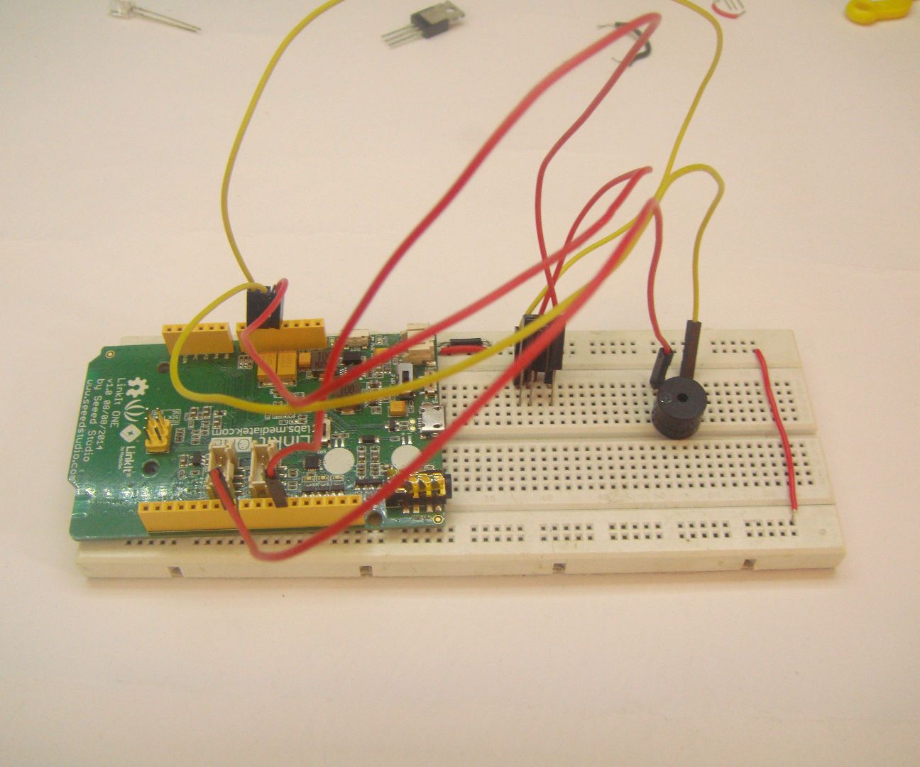

This time I thought of choosing the enclosure before making the project. This would surely help you to make your project properly. This will help you to choose a correct place for your component in the box. First stick your linkit one to your box. I placed my LCD and photocell outside the box so as to save spaceinside the box for other things like battery potensiometer. Stick your linkit one inside your box using tape and drill two holes in it. One for jump cables of photocell and one for wires of LCD.

A photocell is used to receive the beam of laser. The pointer of laser light is kept in such a way that it falls on photocell. The photocell send command to linkit one that laser pointer is falling on it. When there is some obstruction in the laser beam, the photocell tells to linkit one that there is a obstruction a count of number of people is increased. If you do not have a photocell module, you can make one with a LDR. Here are its connections:
- vcc to Linkit one 5V
- gnd to Linkit one gnd
- Vout to linkit one analog pin A0
