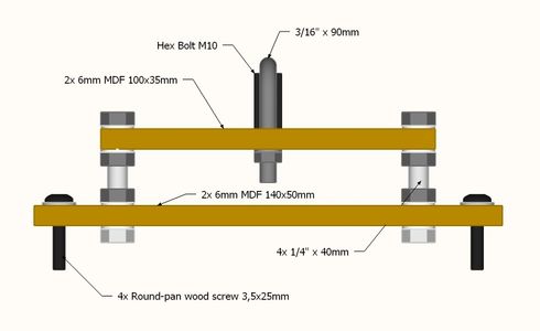

- Bearing Set. You can find in the pictures the way that I used to calculate the distance between the rails to avoid gap in the bearings.
- M10 Nut Set.
M10 Nut Set for X-Axis and Z-Axis.

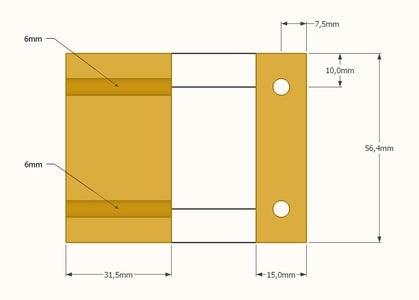

Step 4: Motor Base
The support for the Step motor was made with 3 pieces of MDF 15mm and 6mm thick. The construction is very straight forward and you can find the materials and dimensions in the PDF files attached.
