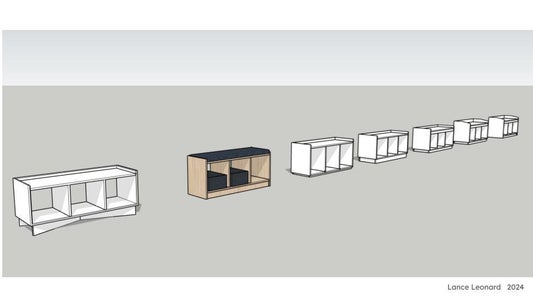

Introduction: Entryway Storage Bench
I built this storage bench to organize the entryway of our home. There are many similar benches that can be purchased, but they were all the wrong size or style for the space I had in mind - so I designed this one to fit perfectly. I paired it with storage boxes from the Container Store, and a custom cushion from Cushion Source.
I used this project to play with a couple different joinery methods (stopped dado, and mortise and loose tenon) either method is perfectly adequate for this build, and could be used as the only joinery method.
This project can be scaled up or down to meet your own needs, or built as designed.

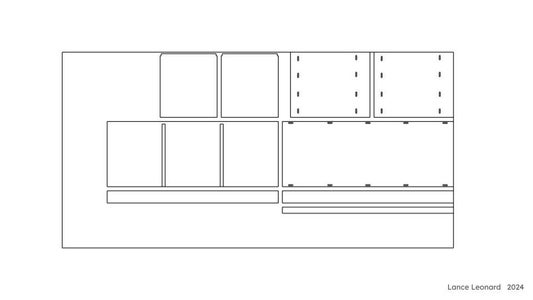

Wood
I milled and glued up all the panels for this project out of 4/4 white oak. If you do not have the capacity to do that in your shop, all pieces can be made from 3/4 inch S4S (surfaced on 4 sides) material that you can get from your local lumber yard, from online wood distributors, or even you big box store home center.
Alternatively, this project can be made from a single sheet of 4 foot by 8 foot 3/4 in plywood.

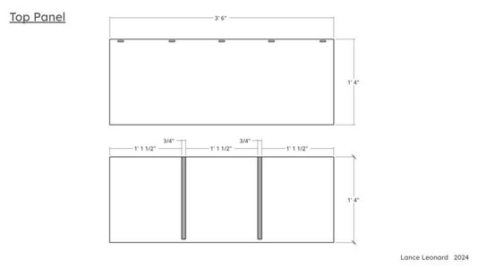

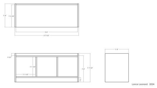

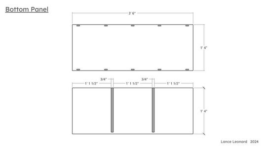

Top and Bottom:
42 in x 16 in (2)

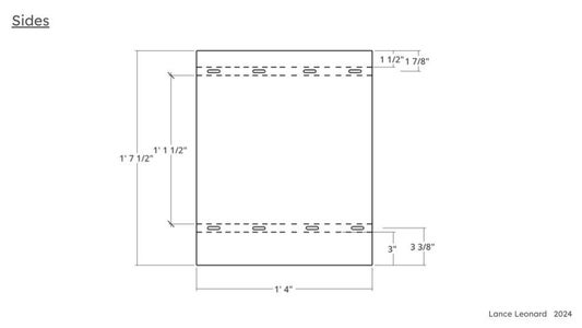

Sides:
19.5 in x 16 in (2)

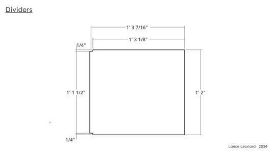

Dividers:
14 in x 15 5/8 in (2)

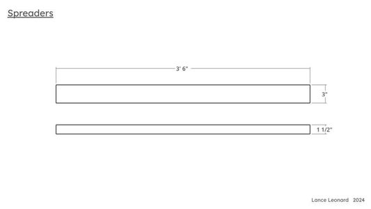

Bottom Stretchers
3 in x 42 in (2)
Top Stretcher
1 1/2 in x 42 in

Each panel is made of three boards.
Mill and Glue
Joint the edges for glue up. I do not have a jointer so I used the table saw with two six foot levels to extend my fence and create a long straight reference surface.
Plane each board to surface both sides and bring the final thickness to 3/4 in.
To help help the boards align and get flush seams I used my router to create 1/4 inch wide, 1/2 inch deep and 1 1/4 inch long mortises along the edge of each panel. These mortises are paired with tenons of the same dimension to aid with alignment during glue up*.
Glue up each panel.
Dimension
Finally, rip and cross cut to final dimension. I used the table saw and a cross cut sled.
*If my planer had a capacity of 16" or greater, I would have glued up the panels first and would not have used mortise and tenons for alignment. I could then surface the whole panel at once and any inconsistencies between boards would be flattened.
Step 2: Stopped Dado for Dividers
Layout
Mark out where the 3/4 in Dados will be cut: 13.5" from each side, and terminating 7/8 in away from the front edge.
Jig and Pattern Bit
I constructed a jig out of 1/2 in mdf for a 1/2 in pattern bit to follow. The mdf guide extends from front to back of the panel, and has a cross member glued 90 degree to the guide. The other side of the guide is adjustable to set the width of the desired dado.
The jig is sandwiched on either side of the divider to set its spacing. The free guide is either clamped down or can be screwed down.
Place the jig on the panel and align to your layout lines. A strip of mdf is clamped between the two guides so that you stop at your mark 7/8 inches from the front edge. This isn't necessary, but I have accidentally routed past my line too many times!
Set the depth of the router bit to extend 1/4 inch past the 1/2 inch mdf guide.
Route the dado.
Shoulder on the Divider
A shoulder has to be cut into the divider that is the same depth as the dado. There are several ways to this, but I use the same router setup. If you do not change the depth of the bit, the router will cut a shoulder that is the exact depth of the dado.
Create a T-shaped jig that can be clapped to the divider, with 1/2 mdf on top for the router to sit on. Use a scrap piece of wood to keep the router from tearing out the back of the shoulder as it finishes the cut.
Test fit your pieces.
Step 3: Mortise and Loose Tenon for Sides and Stretches
Mortises
Layout where components will meet, and mark out where each mortise will go. Mark corresponding mortises on the edge of the mating pieces.
I used a router with 1/4 inch up cut bit and a homemade jig to route mortises that are 1/2 in deep and 1 1/4 in long. I can center my jig over each mortise and clamp in place.
Alternatively, you can use a plunge router along a straight edge. The straight edge is clamped so that the bit aligns where each mortise will go.
Tenons
Tenons are prepared on the table saw (1/4 in x 1 1/8 in x 1 in).

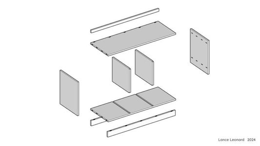

Step 4: Assembly and Finishing
Sanding
Before assembly, sand all interior surfaces. I sanded 120 grit, 150 grit and 180 grit. Exterior surfaces are sanded to 120, and then sanded to 150 and 180 after assembly as the assembly process and clamps can mar the surfaces.
The front stretcher is sanded both sides up to 180, as it cannot be sanded after assembly.
Dividers
Glue and clamp the center dividers into their dados on the top and bottom panels. Clamp and let dry.
Stretches
All stretchers are assembles with their loose tenons and clamped in place. Clamp and let dry.
Sides
Install one side with loose tenons, clamp across the length of the bench and let dry. Do the same to the other side. By doing one side at a time, you will have more time to work before the glue starts setting up.
