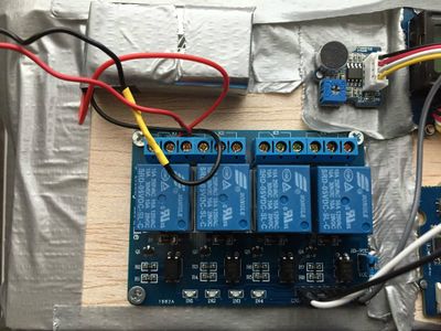

Step 4: Assembling the Fan
In order to activate the fan, we needed a more powerful source of energy than the arduino. To remedy this issue, we used a relay that completes the circuit, relaying power to the fan, when the gas sensor reads a value at or above the threshold for the gases.

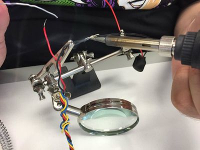

To connect to the relay, we attached a wire from pin 13 on the arduino to the IN1 slot on the relay, another wire from the ground of the arduino to the ground on the relay, and one wire from the 5V slot on the arduino to the VCC on the relay. We then soldered the negative end of the fan to the negative end of the 9V battery clip. The positive end of the battery clip was slotted into the middle port of K1 on the relay and the positive end of the battery was inserted into the right slot of K1 of the relay.
