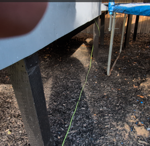

Instead of pouring a massive concrete pad, I opted to build the whole thing on posts. I used a bunch of 4x4 posts set into concrete footers. It's a relatively simple process, but I put mine about 2 feet into the ground, added gravel at the bottom for drainage, and then filled it with concrete. The hardest part was to keep all the posts straight over the 19ft length. A few of the posts were slightly out of place, but I just had to adjust the framing a bit for everything on top. It was my first time doing something like this, so I think it turned out pretty good.
I used some 4x8 beams for the floor support and added 2x4 framing and plywood on top. Once I got a flat platform, I could start building the framing on top.

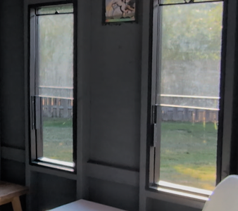

As the rain approached, I sprayed a coat a gray paint on everything, and then added some black accents later. The walls were left with the framing exposed on the inside because I wanted to see how we were going to use the space and adjust it if required. I put the massive 4x8 clear panels up on the sides as windows. It gave it a nice modern design, but more importantly, it gave us a way to monitor the kids from the patio since we could see in.

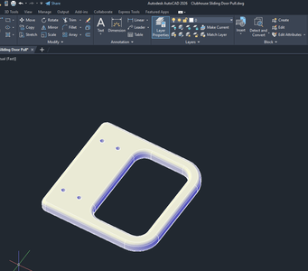

This build was very custom, and I needed to find some custom solutions. To do this, I ended up using AutoCAD to design a variety of items and then 3d printed them. I made all sorts of things like handles for doors, a rack for the Pop Dart game, some brackets for my entry railing, and various things to make my sliding windows work. Add a little furniture and some games, and it was ready for action.
