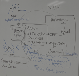

Phase 3: Arduino Integration for Fall Detection
In this phase, I incorporated hardware to create the fall detection feature.
  1. Using an ESP32 microcontroller and an MPU6050 sensor which is a 3-axis gyroscope and 3-axis accelerometer within the wearable, I programmed it to detect when a user falls during a seizure.
  2. The sensor is connected to Google servers and sends personalized emails to emergency contacts when a fall is detected, providing immediate alerts.
