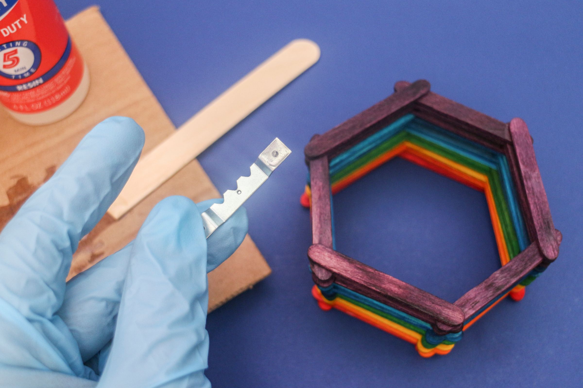

To demonstrate how to mix and apply epoxy resin, we are going to affix some saw-tooth mounts to the shelves from our White Glue Lesson.

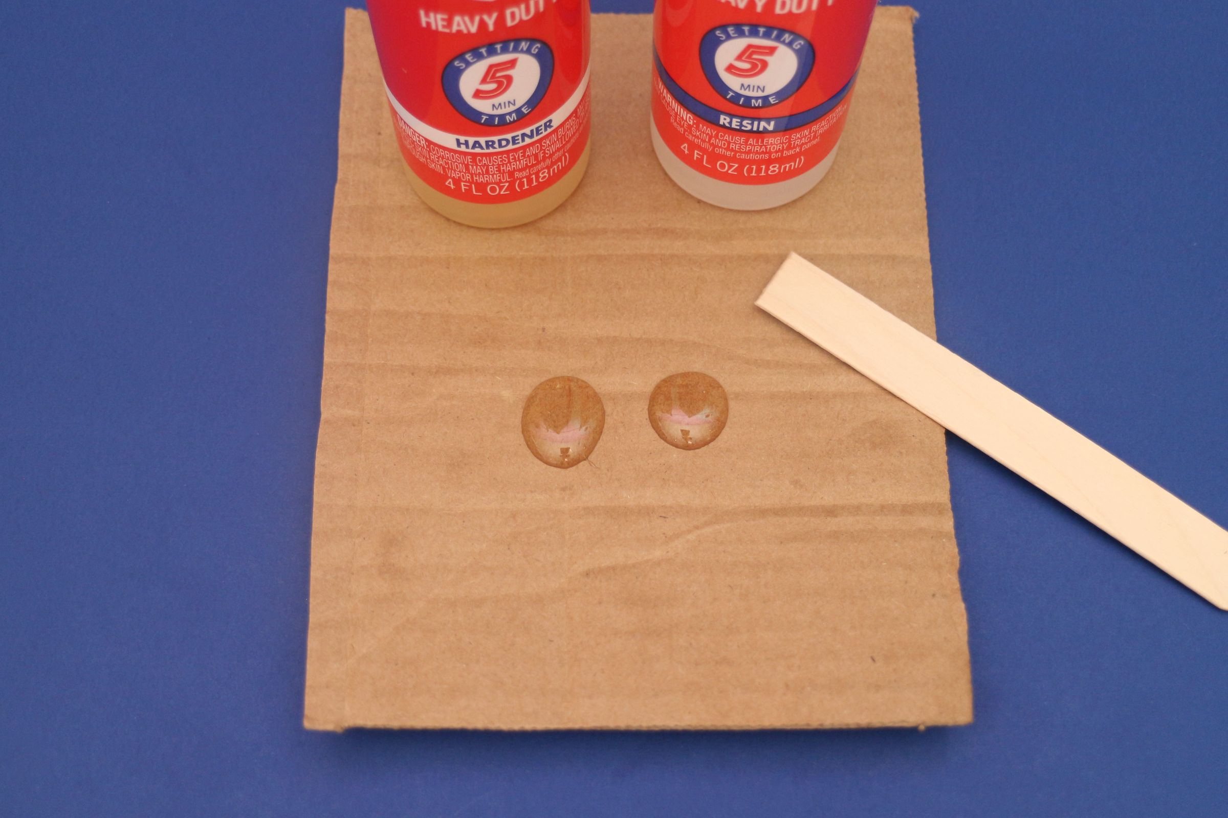

Squeeze equal amounts of resin and hardener onto a dust-free, sturdy, disposable surface. Scrap cardboard or a paper plate works perfectly, but you can also use a silicone mat, the resin will not bond to that.

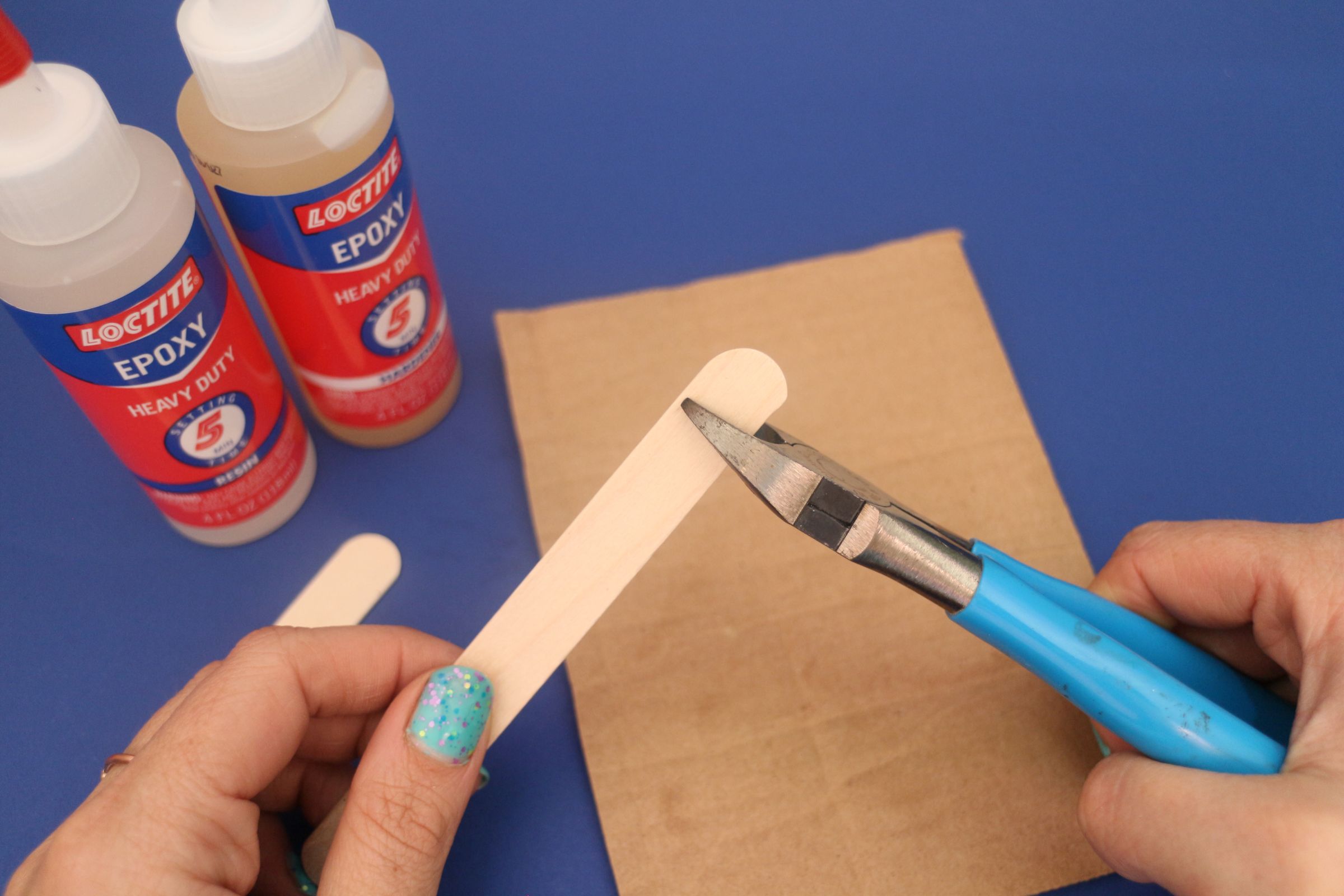

To mix the resin, cut the end off a popsicle stick or tongue depressor. This way you have a flat edge scraping as much of the resin off your flat surface with each pass of the tool.

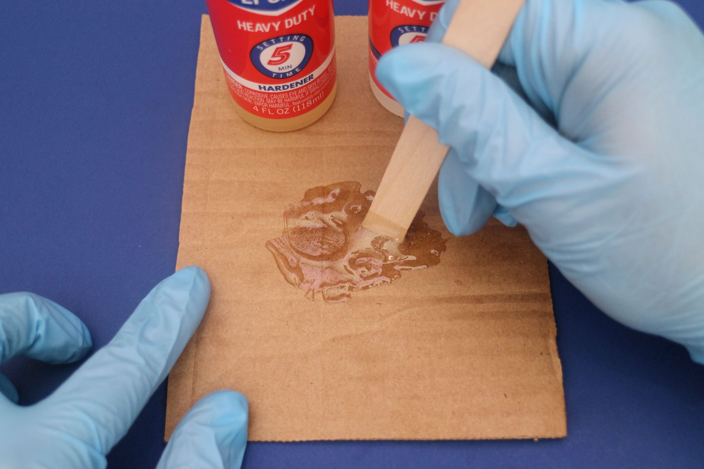

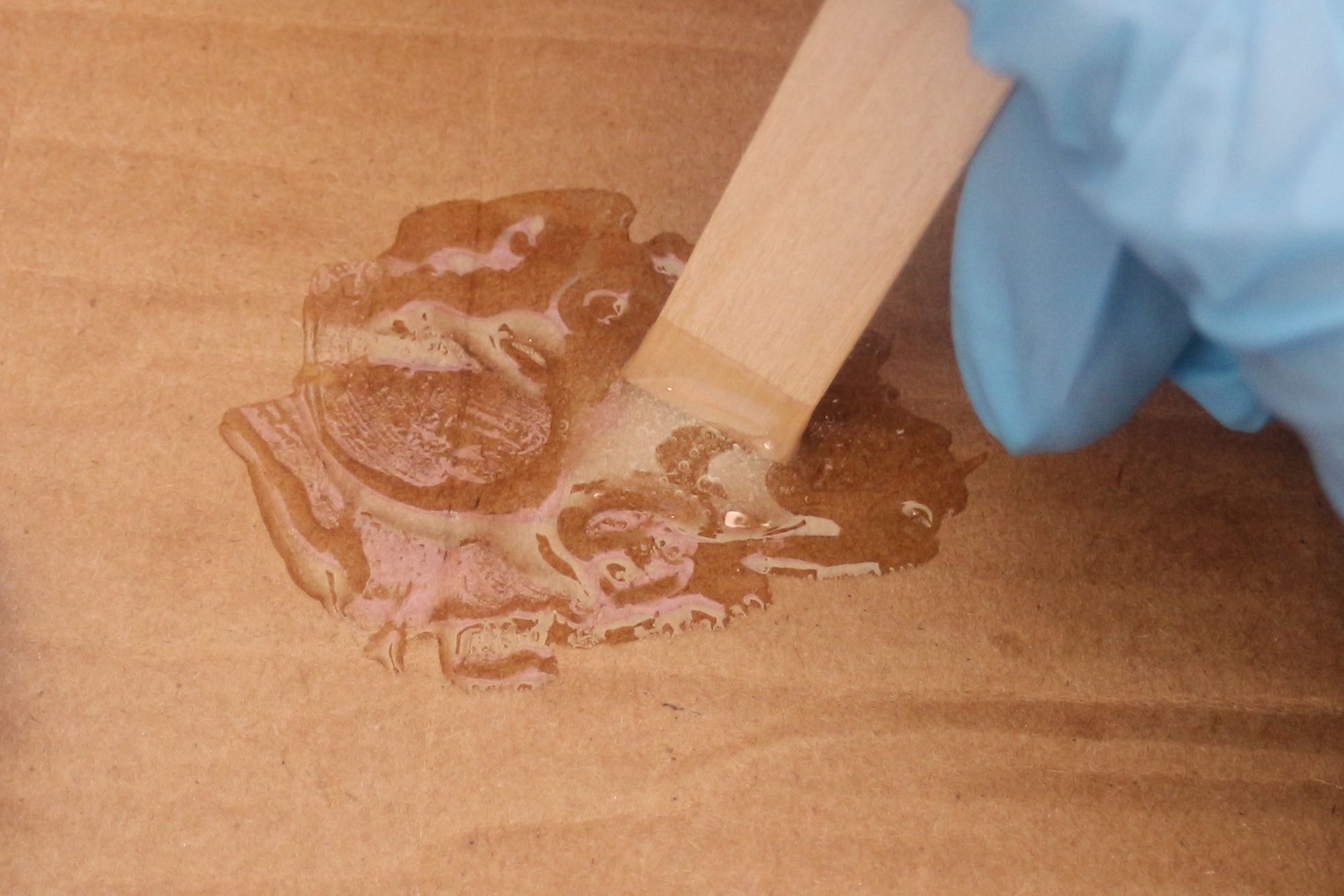

Push the mixture around for about a minute, you can feel it starting to gel as you mix. When the mixture barely drips from the mixing stick it is ready for use.
It is best to prepare as much as you think you can use within the epoxy's specified set time. If you need to apply a large amount of glue to a broader surface area, it is best to work with epoxies with a longer or extended open time. You want to give yourself enough time to mix your adhesive as well as clamp/jig/nest your parts properly.

Using 5-min epoxy, I applied the gelled mixture to the sawtooth mounts. I mixed the epoxy for a little over a minute and let it sit for another minute until the viscosity suited the spread and flow I believed necessary to cover the back of the saw-tooth mounts joining points without overflowing the edges or being too overworked to apply.

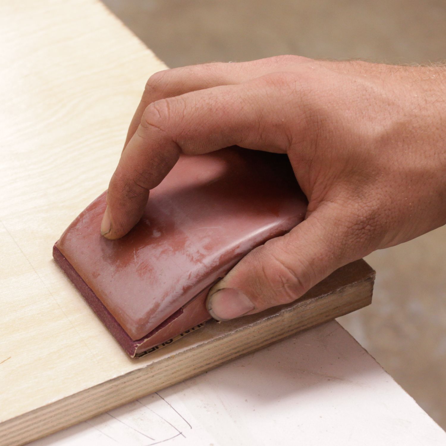

Once the epoxy is cured, you'll have to remove it mechanically. Sanding, chipping, smashing....it's gonna take some effort. This stuff turns from goo into a super-hardened plastic, so do your best to apply precisely and be sure to wear plenty of PPE!
If you really need to get a coat of epoxy off a surface, you can use a heat gun to soften the epoxy. Heat a small area and use a paint knife or cabinet scraper to remove the bulk of the coating. Be sure to work in space with lots of ventilation when heating epoxy, it can off-gas quite a bit. Sand the surface to remove the remaining material.
