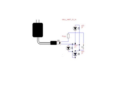

Materials: a piece of swampwood, cardboard, rest beech board, clear epoxy resin, mini switch, dc socket, wire,
wood wax, solder, 2 red LED´s, 1 yellow flickering LED, 1 clear color changing RGB LED, piece of leather, 2 small screws, filler, glue, 15V power adapter with dc plug and LED, 580 ohm resistor,

Glue the LED´s in the base screw the switch in the base. Place the DC socket and solder the electronics as on the circuit diagram. Check if it works! Drill small holes in the base and screw it together with the swampwood. Fill the underside with filler. Find a matching piece of leather and mark the base on the underside. Cut it with a scissor and glue it on the underside.

Open the power adapter and check with another led wich pole is plus on the original LED.Remove the original red LED and solder the new color changing clear RGB LED. Drill the LED hole in the power adapter a bit bigger. Screw the power adapter together with new screws. Check if it works. Plug the DC plug in the base, turn the switch. Check if everything is working fine and enjoy.
