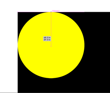

Toolpath generating programs (like FUSION 360) love working with DXF files. In order to create proper inlay geometry using Adobe Illustrator, it's important to be able to create graphics that contain rounded corners that are the same radius as our router bit's radius. We use a 3/16" fluted downspiral bit shown above.
In order to find the radius, you must find the decimal equivalent of 3/16" and divide by /2.
After finding the measurement, round up to the nearest thousandth and use this value to create a circle to represent our router bit in Adobe Illustrator without a stroke.
Notice the size of the Artboard - we are limited to our detail level in our design based off of the size of the bit involved. If fine details are a must, we must resort to other methods, such as raster engraving w/ the laser or vinyl cutting decals to achieve the desired look.
In this example, we will transform the font "PATRIOTS" to work with our router bit to create a seamless inlay. With the "P" selected with the Direct Selection Tool (Hotkey "A") Double click on the dynamic corner button to enter in the radius of .094" (1/2 of our router bit diameter rounded up) to create a smooth corner. You know should have a beautiful corner that will fit perfectly to our bit as seen in the pics above.

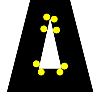

IMPORTANT NOTE: Only OUTSIDE CORNERS need to be rounded. The router bit can sharp edges on inside corners as the bit travels AROUND the object. Think of the inside triangle of the "A". The bit can go around the triangle to produce the exact shape with sharp corners. It's important in the design phase to create something where MOST of the detail of a desired image is achieved.
NOTE: Although sharp corners can be achieved with inside geometry, different material thickness and densities react differently and may chip out if too thin and or narrow resulting in voids in your inlay. Practice with your material of choice.

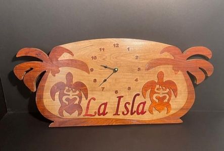

I ended up not even creating an inlay with my design as changing my design to a epoxy pour, but students' work turned out awesome as seen is some of these pics.
