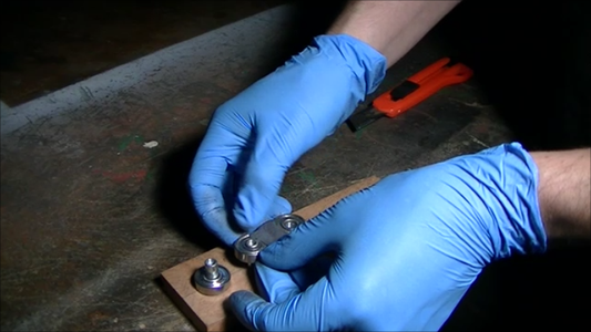

So my idea was to use the wood as a work surface to flatten and shape the epoxy putty but, it being epoxy putty, it started to stick to the wood. So instead I removed the two bearings and worked it in to shape freehand. I would go back to the jig to make sure the spacing was correct. It takes about 5 minutes for the putty to start to harden. Once it starts to harden I was able to shape it a little better again using the jig to make sure the spacing was correct.
Step 11:
Once the putty started to dry and stiffen up I used a razor to trim the excess on both the top and bottom. Here I also used another bit of the roller blade wheel hardware for the jig. The roller blade wheels also had a small spacer as a part of the wheel assembly. The small spacer slides over the axle hardware and keeps the bearing off the surface of the wood. You can see the spacers in the second picture.
Step 12:
Then I just repeated the process for the other side. I shaped it and then trimmed the excess. I let the epoxy putty dry for at least one hour per the package instructions before moving on to the next step.

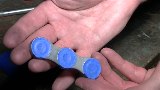

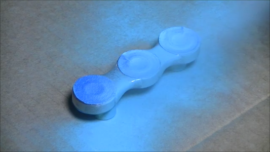

In order to prep the piece for paint I used some blue tape to make some masking off circles for the bearings. I put down some blue tape with the sticky side up. Then I place a bearing on the tape and use a razor to cut along the perimeter of the circle. Once its cut I peel off the blue tape and use it to mask off the bearings on the spinner.
Step 15:
Now that the masking was in place I painted the entire exposed surface with two coats of spray paint. I didn't add any clear coat but that would probably be a good idea considering how much these will get handled. I would suggest at least 2-3 coats of clear so that the paint will last longer. The last picture shows a before and after paint.
Step 16:
They seem to spin fairly well considering that the bearings are not that great. When it comes to bearings you definitely get what you pay for. The balance is ok but could be better. Overall not bad for a first attempt. I hope you enjoyed this Instructable.
