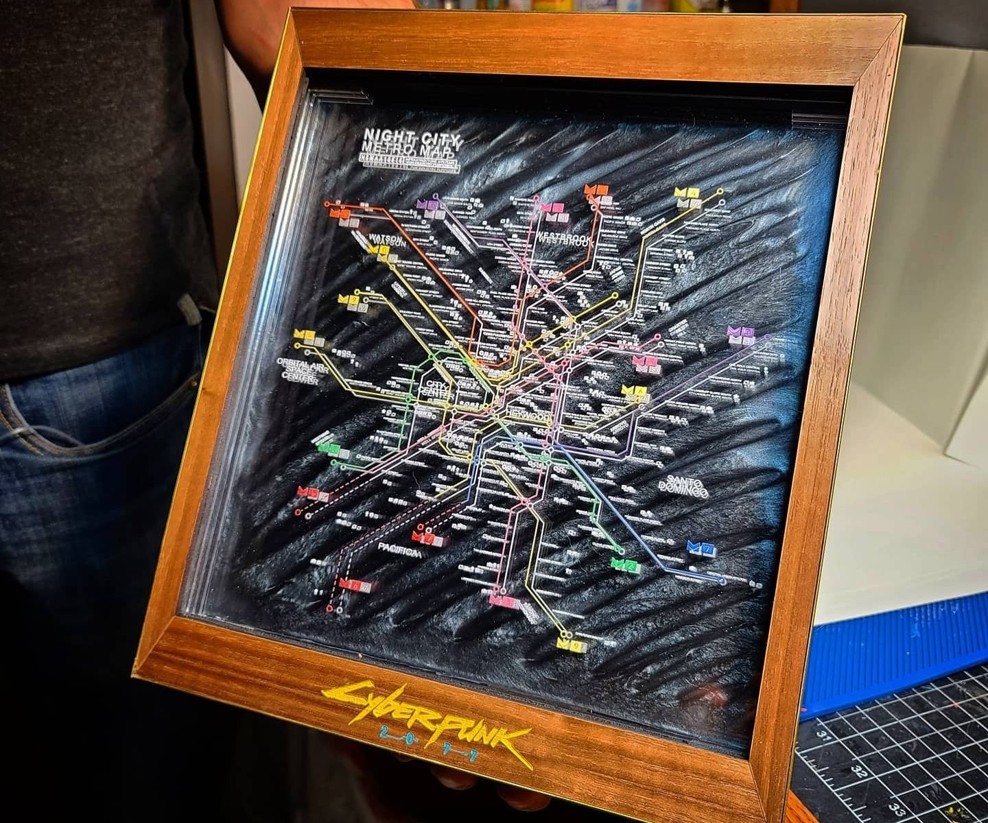

Step 1: Laser Cut the Pieces
There are 4 separate layers to all of the maps I make
- Back 1/8th inch thick MDF Panel
- Main Land Masses Panel with resin safe border made from 1/8th inch thick Plywood
- Acrylic Panel made on 1/8th inch thick Clear Cast Acrylic
- Veneer Border pieces made on 1/32nd inch thick adhesive-backed veneer.
Start by cutting out the pieces using the appropriate settings on your laser cutter. I use Glowforge Proofgrade settings for my materials as they are the machine presets values. Make sure to figure out what settings would work best for your own machine.
Shown is an image of how I set up my files for laser cutting.
Step 2: Assemble and Prep for Resin
- Start by gluing the panel with the Land Masses to the MDF board with E6000 Craft Glue. (photo 1)
- Using sewing clips, hold down the two layers to ensure maximum contact and to maintain alignment.(photo 2)
- Use CA Glue to seal off any areas around the border that the resin will come in contact with. (photo 2)
- This will ensure you will not have leaks when you pour the resin in the "ocean areas"
- Paint the board engraves based on what every preference you have. (photo 3)
- I personally like to paint all the engraves on the Land Masses panel black before removing the masking tape. (photo 4)
- After removing the masking tape, use Paint Pens to paint in all the trees (photo 5)
