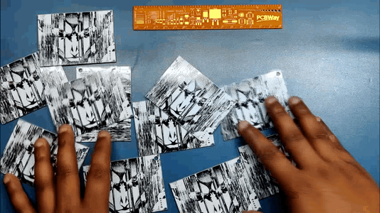

So this is the EREN YEAGER PCB ART or a Blinky Board which is based around 555 Timer IC.
On the TOP side, I've added a custom silkscreen layer that consists of a BMP image of EREN YEAGER Titan form.
For those of you who have no idea who or what EREN YEAGER is, well let's just say he's one very disturbed lad from a fictional show called "AOT or Attack on titan"
I made this setup as a soldering challenge kit, We solder all the SMD components with a soldering iron and the end result will be a complete Bi-Flasher working circuit which is themed after our beloved hero turned antagonist EREN YEAGER.

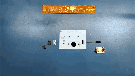

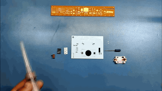

  • Eren Yeager PCB
  • 555 timer IC
  • 10K Resistor
  • Coin cell holder
  • CR2032 Coin cell
  • 22uf Capacitor
  • Slide Switch
  • RED 0805 LEDs

Step 2: EREN YEAGER Silkscreen
After preparing the schematic, I move on to the PCB Making Part.
The main aspect of this Board was the custom EREN YEAGER image, I first search around for a black and white image of a close-up shot of EREN YEAGER NEW FORM.
To import it into my OrCad PCB Suite, I had to convert it from JPEG to BMP as my PCB SUITE only imports images from BMP format.
I then imported the image in my PCB DESIGN and place all the components in the opposite layer which was the bottom layer.
EREN YEAGER image will be on the TOP layer and all the components will be placed from the bottom layer.
After placing everything and finalizing the board, I send its Gerber data to PCBWAY for samples.
Step 3: Getting PCBs From PCBWAY
I used PCBWAY PCB Service for this project. I uploaded the Gerber file of this project on PCBWAY's quote page. For this PCB ART BOARD, I went with White Soldermask and Black silkscreen.
After placing the order, I received the PCBs in a week and the PCB quality was pretty great, the silkscreen I used is completely random and asymmetrical so it's pretty hard to make but they did an awesome job of making this PCB with no error whatsoever.

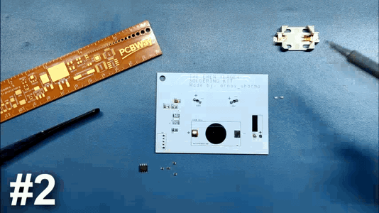

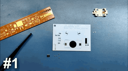

Step 5: #1 ADDING SOLDER TO ONE SIDE FIRST
  • First set up your soldering station with an Iron Tip Temp of 316°- 343°C.
  • We start by adding solder to each component pad first, just on one side.
Step 6: #2 ADDING IC & RESISTORS
  • We now add the timer IC in its place and all the 10K Resistors by picking them up with a tweezer and heating up the solder we added on one side of the board
  • this will hold the component from one side, we then later add solder to the other side of the component

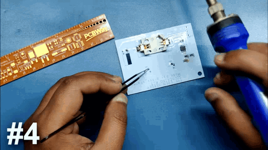

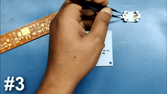

Step 7: #3 COIN CELL HOLDER
  • Now we place the coin cell holder in its place by lifting it up with a tweezer and placing it on its assigned pad in right polarity, then heating the one side of its pad to solder it from one side. then we apply solder to its other pad.

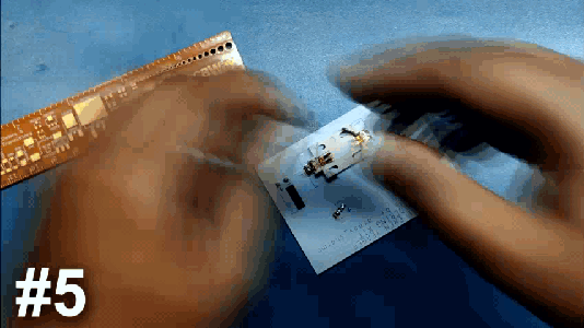

Step 9: #5 ADDING SLIDE SWITCH
  • Now we add a slide switch from the BOTTOM side of the board, its pad will be soldered from the topside.

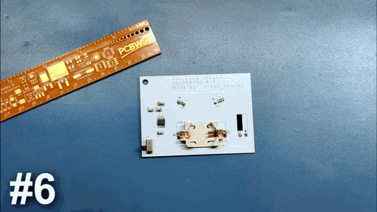

Step 10: #6 ADDING CAPACITOR
  • At last, we add 22uf Capacitor to its place, now I've removed the general holes that are required for soldering THT Capacitor, instead, I've added pads.
  • we add a capacitor to these pads from the BOTTOM SIDE of the board.
  • The Circuit is now complete.

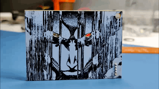

Step 11: RESULT
For powering this badge, we have to add a CP2032 Lithium Coin cell in its holder and turn on the switch. Both LEDs will start flickering in a chasing sequence, the first led will glow and the second will stay low, then the second led will turn HIGH and the first led will turn LOW, and this process will get repeated over and over.
