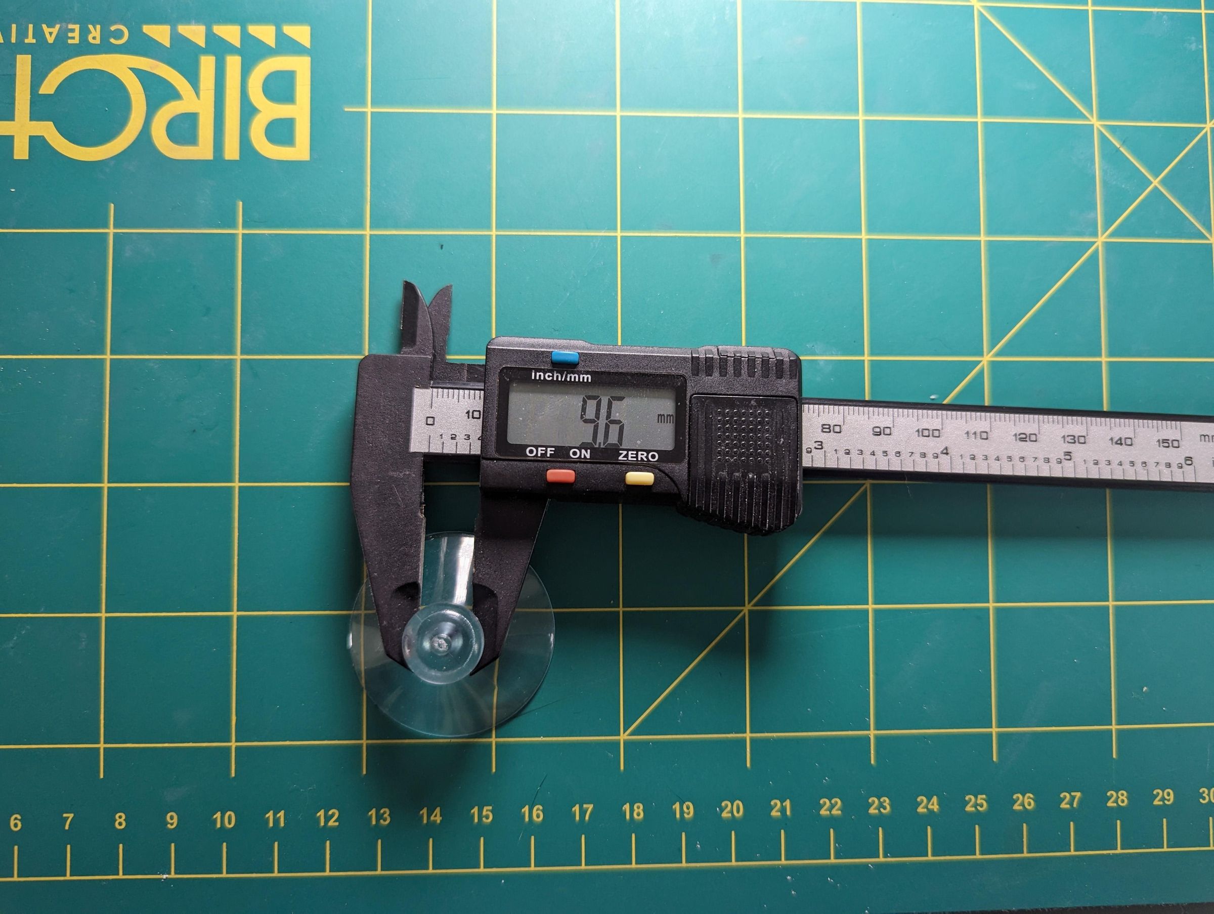

  7. Suction cups. Something like this. For the suction cup, anything with a hook diameter of around 9-10 mm will work.
