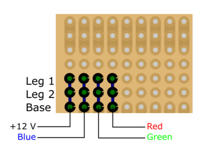

Step 15: Making the Custom PCB
Permanently soldering the LED strips together would be messy and wouldn't give room for troubleshooting, therefore we decided to design and make a custom PCB. We learnt the process with the help of instructables' free PCB design class. Follow the circuit diagram attached above. With this design, we can use standard jumper wires to connect the led strips to the header pins.
Step 16: Fitting the Electronics Compartment
The last step is to connect all the electronics. We started by gluing 4 sides of our box together with hot glue. Then we made a removable clear acrylic panel for the back so that it is convenient to access the electronics. Using dabs of hot glue we mounted all the components (the IR controller, the pcb and the battery). Once done you can push in the switch and the IR receiver in their slots on the front panel. Finally connect the circuit like so:
  • Leg 1 Led Strip >> PCB 1st row (+ 12v, B, G, R)
  • Leg 2 Led Strip >> PCB 2nd row (+ 12v, B, G, R)
  • Base Led Strip >> PCB 3rd row (+ 12v, B, G, R)
  • Base Led Strip (Plug end) >> Led Box Plug
  • 9v Battery >> Led Box
Note : we have included a circuit diagram, have a look if any doubt occurs.
