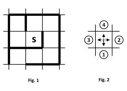

Step 1: Basic Behavior
Perhaps we are in a start position (point S) of a maze (Fig. 1) and we decided to select direction according to following scheme (Fig. 2): downwards - if possible (direction 1), otherwise rightwards - if possible (direction 2), otherwise leftwards - if possible (direction 3), otherwise upwards - if possible (direction 4). So, if your current position (point S) has no walls around the next motion will be downwards. Opposite situation if all the directions are closed by walls - you are in impasse.
