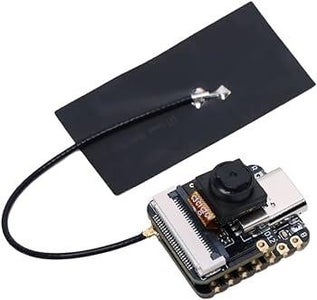

Step 2: Hardware Setup of Esp32 S3 Sense:-

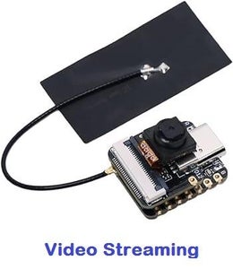

For setting up a video streaming server on esp32 S3 sense. you need to connect the wifi antenna to the esp32 board and the camera module to the board as well as shown in figure above.
The esp32 s3 sense module needs to connect to your network router. For which you need the SSID of the router and the password of the router. Over here esp32 s3 sense module is setup as a video streaming Webserver.

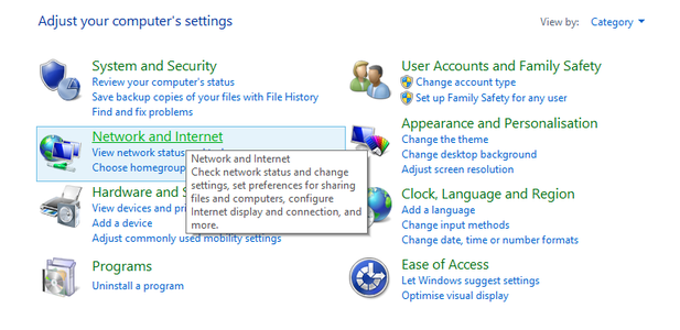

Step 1:-

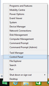

Right click on windows icon and click on control panel.
A control panel window will open.

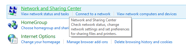

Step 2:-
On control panel window click on network and internet.
Step 3:-
click on network and sharing.

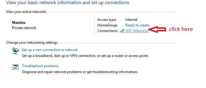

Step 4:-

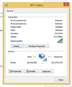

Click on wifi link to get wifi status window.
Step 5:-
A wifi status window will appear on it click on wireless properties.
Copy the SSID on a notepad.

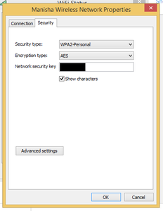

Step 6:-
click on security tab of wireless properties window and check on show character to look for password.
copy the password on a notepad as it is required for letting your webserver connect to your router.

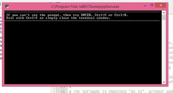

Step 6:-
Click on open system shell.
Step 7:-
A command window will open.
Step 8:-
click CTRL+B to open python shell.
step 9:-
click CTRL+T to close the command window.

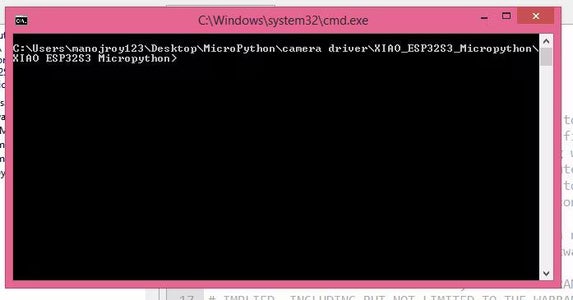

step 12:-
Step 13:-

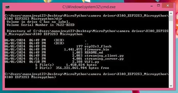

Go to the location when "esp32s3_flash", "firmware.bin", "README.md", "streaming_client.py", "streaming_server.py", "Wifi.py" is located and type dir.

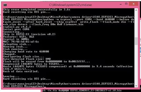

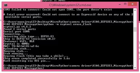

Set the esp32 s3 sense in boot mode by pressing the boot button and connecting it to the usb. and then type the following command "python -m esptool erase_flash". as shown bellow, if successful you will get output.
Copy the serial port no in text file over here it is "COM4". Since we need this comport no to flash the firmware file in it.
Step 15:-
Know to upload the micro python firmware with camera driver type the following command in the command prompt "python -m esptool --port COM4 --baud 460800 --before default-reset --after hard_reset --chip esp32s3 write_flash --flash_mode dio --flash_size detect --flash_freq 80m 0x0 firmware.bin". Output will be shown.

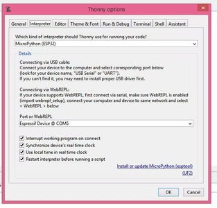

Open thonny and than click on tools.
Step 18:-
On it click on Options.
Step 19:-

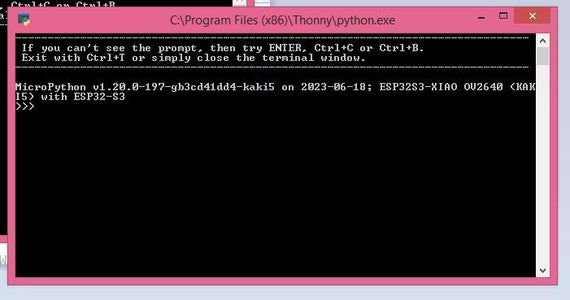

A window will appear. On it click on interpreter select interpreter as "MicroPython (esp32) " and port as "Espressif Device @ COM5".
click ok and you will see python prompt in main thonny window.
Step 20:-
test the micropython by running a simple python command like print("Hello") on main window and press F5. you will see the output of it in the python prompt.
