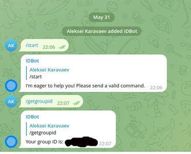

Step 2: Add Your Bot to Group and Get Group Id
Now we need to create a telegram group for our bot and find out the group id.
  1. Create a telegram group.
  2. Add your newly created bot there.
  3. Add t.me/myidbot
  4. Retrieve group id from t.me/myidbot using /getgroupid command
  5. Save the group id, you will need to insert it into your code.

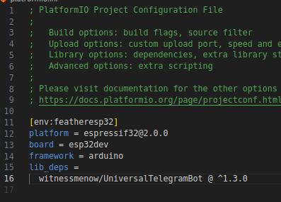

Step 4: Create PlatformIO Project
If you want to use Arduino IDE, skip this step.
Create a project in PlatformIO, use Adafruit Esp32 Feather as the board. (In most cases It doesn't matter what board you choose as long as the core chip is the same(Esp32 in our case))
Check the plaformio.ini file and copy the configuration (It specifies espressif framework version platform = espressif32@2.0.0 that this example was tested with and sets the board=esp32dev, and adds all the necessary libraries). platformio.ini should look something like this:
[env:featheresp32]
board = esp32dev
framework = arduino
lib_deps =
witnessmenow/UniversalTelegramBot @ ^1.3.0

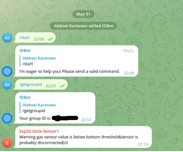

Step 7: Test the System
  1. Plug Ethernet cable in, wait a few seconds before the device connects to the Internet.
  2. You can use your normal lighter for testing, just press the gas button without starting a fire. Alternatively you can disconnect 5V from sensor for a few seconds, the bot will detect it and send you a message.
  3. Check your Telegram you should receive message from you bot!
