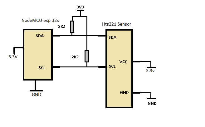

Step 1: Step 1 : Hardware Connection
The hts221 Temp and humidty sensor uses I2C connection, You have to connect the sensor to the appropriate pins in the ESp32
Node-MCU Esp32s Hts221 Sensor
3v3 pin --> 3.3v pin
GND pin --> GND pin
IO26 --> SCL pin
IO25 --> SDA pin
