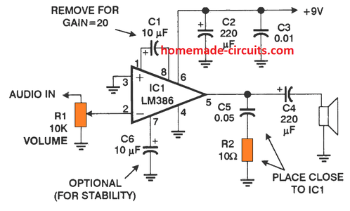

-Lm368 Amp schematic
-potentiometer pin out

Building the amp
Pin 1 of the lm386 connected to pin 8 of the lm386 through a 10uf cap
Pin 2 of the lm386 connected to OUTPUT pin of the 10K potentiometer
VCC pin ot the potentiometer connected to RX Pin of the esp8266
GND pin ot the potentiometer connected to GND pin of the esp8266
Pin 3 and pin 4 of the lm386 connected to GND pin of th esp8266
Pin 7 of the lm386 connected to GND through 10uf capacitor.
Pin 6 of the lm386 connected to VIN pin of the esp8266
Pin 6 of the lm386 connected to GND through 0.01uf capacitor
Pin 6 of the lm386 connected to GND through 220uf capacitor
Pin 5 of the lm386 connected to the + (positive) of the speaker through 220uf capacitor
Pin 5 of the lm386 connected to GND through 0.05uf cap and 10R resistor in series connecrion.
