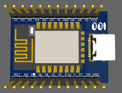

Here is the esp8266 shield, I made this to program esp8266 easily and will make a dedicated programmer board soon.

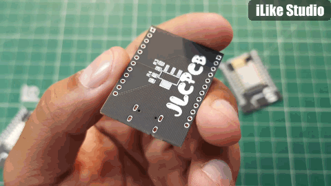

Step 3: Esp8266 Shield:
I build a ESP8266 SHIELD keeping breadboard compatibilities with easy programming in mind. AMS1117 3.3v voltage regulator is there to power up the ESP8266 MCU that works at 3.3v DC. A 10k resistor is connected between enable and VCC pin to make it logic 1 when programming. GPIO 15 is pulled down with an another 10k resistor. A USB type C female jack is connected to power up the microcontroller.
Step 4: Programming:
Because this is a stand-alone shield having only microcontroller, it doesn’t support programming directly through USB. TO program the shield either you need an external programmer or a Nodemcu development board. See how to program the ESP8266 from here. We will build a dedicated programmer board for this shield that can be directly plugged to it with the help of pin headers.

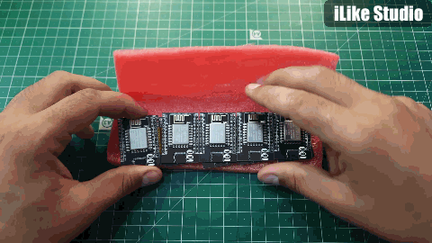

Step 5: JLCPCB Assembled Boards:
Esp8266 microcontroller is very cheap and I need a lot of them for home automation and project making. I tried JLCPCB SMT assembly service which costs me just $8 for assembling and soldering.
The assembled boards are really outstanding, all the components used are original and soldered properly on place. JLCPCB has just launched an another PCBA service which supports dual side components assembly. Visit JLCPCB from here and explore all the service offered by them.
Step 6: PCB Specs:
I designed the circuit schematics in EasyEDA and then export all the required files for PCB assembly service. It is a double layer PCB with HASL finishing and 1.6mm thickness. If you want to use the same designs as mine then download them from here. Try JLCPCB SMT assembly service and get free coupons of worth $54 on first sign-up.

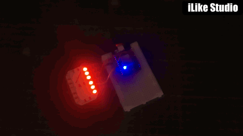

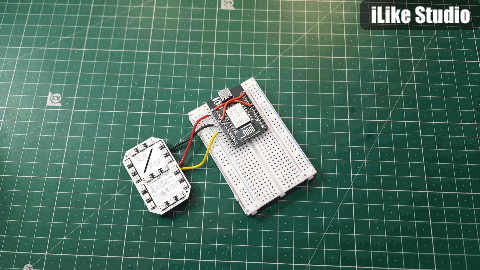

Step 7: Working:
I upload first program to test the neo pixel led 7 segment display. And this microcontroller is working very fine with this. You can access all the functions of the MCU and it’s better to order it from JLCPCB Assembled service. You can see some cross connection in the above displayed GIF is because I forget to connect the tracks of VCC to voltage regulator but fixed in the Gerber file provided for download. You can also cross check the connection from the circuit diagram file given below.
