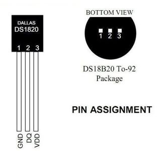

Solder wires onto the feet of the DS18B20, make sure you have the correct pinout.
Now solder the wires to the prototype board. GND goes to G, DQ goes to D5 and VDD goes to 3.3V

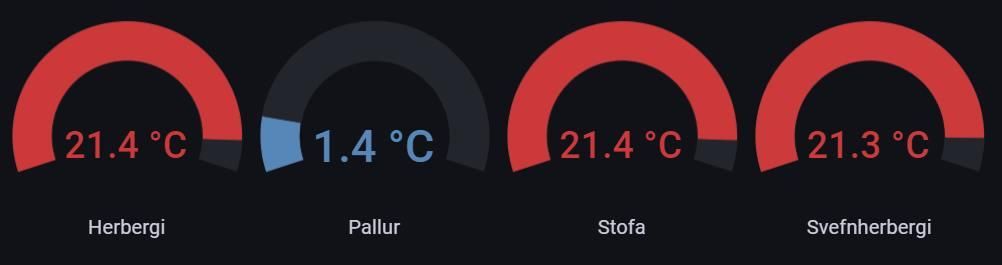

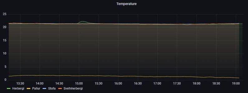

Step 3: Running
From your terminal start the server.py, you should now see data coming in.
Configure Grafana to your likings, wether it be a graphs, lines og gauges.

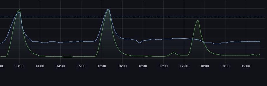

Step 5: Update
After running the system for a few days I started to notice I was getting weird spikes on two of the sensors, and what was even more weird is they were happening at the same time on both sensors, with exactly 2hours and 10min between.
Both were directly connected to 5V PSU, while two others, were running un a battery and not showing said spikes.
Added a battery to another one, but was still getting spikes, switched locations (to eliminate any localised interference) but still spikes.
Last thing to try was to increase the length of the wires going from the D1 mini to the DS18B20, and low and behold, no more spikes.
