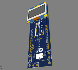

Step 1: Hardware
Hardware
This project requires pcb assembly and soldering skills. Here is The pre-made board and the schematic.
https://oshwlab.com/rotabox/gardencontrolmcu
wiring and assembled in a water resistant project box.
General Hardware Description
An ESP8266 with 4MB (32Mb) of flash is required. The software makes extensive use of the flash storage for both OTA updates and spiffs. Generally this is an ESP-12x, but other models may be used. In my case I used a ESP8266 lolin v3 board. the usb to serial interface built on board. It also includes a nodemcu type reset and programming circuit.
The 4 valves are controlled through the ESP8266 pins GPIO15 GPIO13 GPIO12 GPIO14.
The ESP8266 pins are connected via resistors (10k or so) to the 4 NPN transistors acting as switches.
The transistors drives 4 12vdc solenoids valves. The solenoids contacts connect 12vdc to the corresponding output, and therefore energize a the solenoids.
The ST1306 OLED is an I2C device and therefore connected to SCL (GPIO5) and SDA (GPIO4) of the ESP8266.
For the optional real time clock (pcf8563 or ds1307),
The following schematic can be used as a guide. A schematic file is also included. It is also just a guide. Again DIY assembly and soldering skills are required to complete this project.
Step 2: Pcb Schematic and Assembly
Back side of the pcb:
- solder the 4X 10K resistors
- solder the 4X 2n2222 transistors
- solder the lm7805 regulator
- solder the 4X 1n4148 diodes
- solder the 12V Dc socket
- solder the 2X 100uf Caps
- solder the 2X 0.1uf caps
Front side of the pcb:
- solder the 2 rows of 16 female headers for the Esp8266
- solder row of 4 female headers for the I2C screen
Esp8266:
- solder the 2 rows of 16 male headers on the Esp8266
I2C Screen:
- solder the row of 4 male headers on the i2c screen
after soldering all components place the esp8266 on the PCB in the right direction by
inserting the male headers to the female headers on the board.
then place the i2c screen by inserting the 4 male headers to the 4 female headers on the board.
connect every solonoid positive tap to the 12VDC pads on the pcb
connect each solonoid negative tap to the SOL1 / SOL2 / SOL3 / SOL4 pads on the pcb.
Remember to power up the ESP8266 only from one source (usb or 12vdc) so if you using usb to power up the ESP8266 do not connect the 12VDC to power and via revers. that may cause damage to the ESP8266.
Tip: you can use usb cable with unconnected 5vdc pin to keep ide live for monitoring and programing when the 12vdc is power the system.
