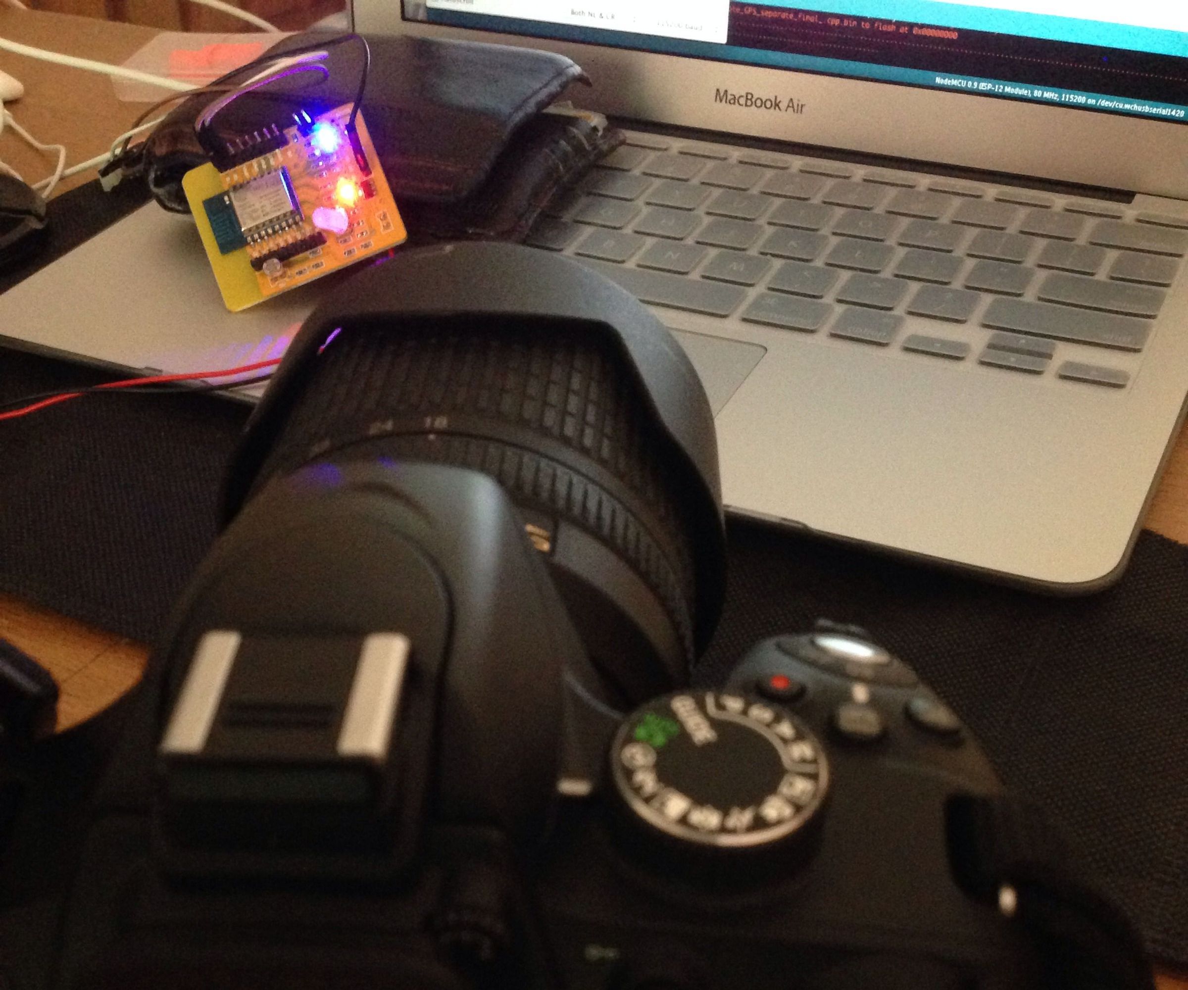

In this instructable I'm going to illustrate the use of web sockets with the ESP8266 micro controller. With this project you can use a web browser to run a web socket client to control RGB LED connected to output pins on the ESP8266 mcu. The RGB can be controlled by sliders or using a smartphone's accelerometer.The response is quite fast with minimum lag however results may vary.

Download the sketch provided in the attachment, open it in Arduino IDE and write it to ESP
The file "espwithNetwork.ino" sets the ESp to connect to your home network.
You need to change the SSID and PASSWORD accordingly. Also change the following
  • const int bluePin = 13;
  • const int redPin = 15;
  • const int greenPin = 12
according to pins you connected RGB to .
If you want to set up ESP8266 as an access point and the control the pin locally, download the second file"espasAP.ino" instead. Here also you need to setup your ap SSID and desired Password. then you can connect computer running web server client to the ESP access point using the credentials.
