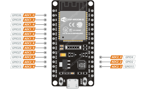

The ESP32 is equipped with two 12-bit SAR (Successive Approximation Register) ADCs: ADC1 and ADC2. These ADCs support measurements on a total of 18 channels, referred to as analog-enabled pins. ADC1 can be accessed via eight GPIOs, specifically GPIOs 32 to 39, while ADC2 is available on ten GPIOs: GPIOs 0, 2, 4, and 12 to 15, as well as GPIOs 25 to 27.
However, it’s important to note that the DEVKIT V1 DOIT board, which has 30 GPIOs, only provides 15 ADC channels, as depicted in the figure below.The ESP32 is equipped with two 12-bit SAR (Successive Approximation Register) ADCs: ADC1 and ADC2. These ADCs support measurements on a total of 18 channels, referred to as analog-enabled pins. ADC1 can be accessed via eight GPIOs, specifically GPIOs 32 to 39, while ADC2 is available on ten GPIOs: GPIOs 0, 2, 4, and 12 to 15, as well as GPIOs 25 to 27.

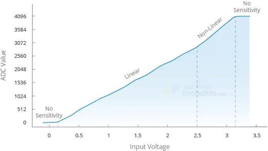

Step 5: ADC Accuracy
While one might expect linear behavior from the ADC, the ADC converters on the ESP32 are inherently non-linear. This means that the measured values may not follow a straight line as expected. Detailed information and discussions about this non-linearity can be found on platforms like GitHub.
The graph below illustrates the non-linearities at the lower and upper ends of the input voltage range.
As a result, the ESP32 cannot distinguish between voltages very close to each other. For instance, it cannot differentiate between 3.2V and 3.3V; the measured value will be the same (4095). Similarly, it cannot distinguish between 0V and 0.13V signals; the measured value will be the same (0).

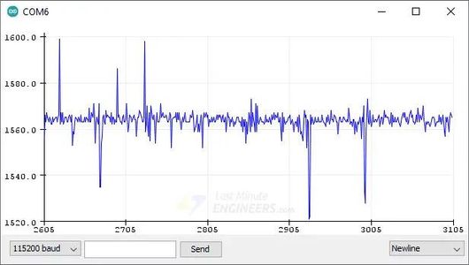

Step 6: Electrical Noise
The ADC of the ESP32 is susceptible to electrical noise, which can introduce slight fluctuations in measurements. To mitigate this, techniques such as adding a capacitor at the output and oversampling can be employed to improve accuracy and reduce noise.

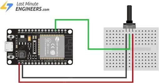

Hardware Setup
Let’s set up a basic circuit using a potentiometer for this example.
Begin by inserting the potentiometer into your breadboard. Connect the middle pin of the potentiometer to GPIO 34 on your ESP32. Then, connect one of the outer pins of the potentiometer (it doesn’t matter which one) to the 3V3 pin of the ESP32, and connect the other outer pin to the ground.

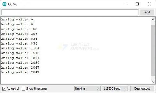

Once you have uploaded the sketch, open the Serial Monitor with a baud rate of 115200 and press the EN button on the ESP32.
You should observe a value between 0 and 4095, depending on the current position of the potentiometer’s knob, being displayed in the Serial Monitor. Try rotating the knob on the potentiometer to observe how the values change.Once you have uploaded the sketch, open the Serial Monitor with a baud rate of 115200 and press the EN button on the ESP32.
