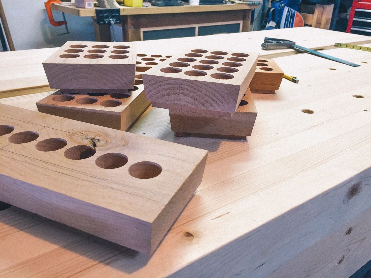

Step 2: Cutting the Angles and Rabbet
First, I cut my 6° angles. Make sure you cut the angles on the end grain first so you don't get blowout. Then cut the sides. Cutting the sides last will cut away any blowout you may get when cutting the end grain.
Second, I took my pieces over to the router. I raised the blade about 3/8" to give the floating effect I was after. Again, cut your end grain first, then do your sides.

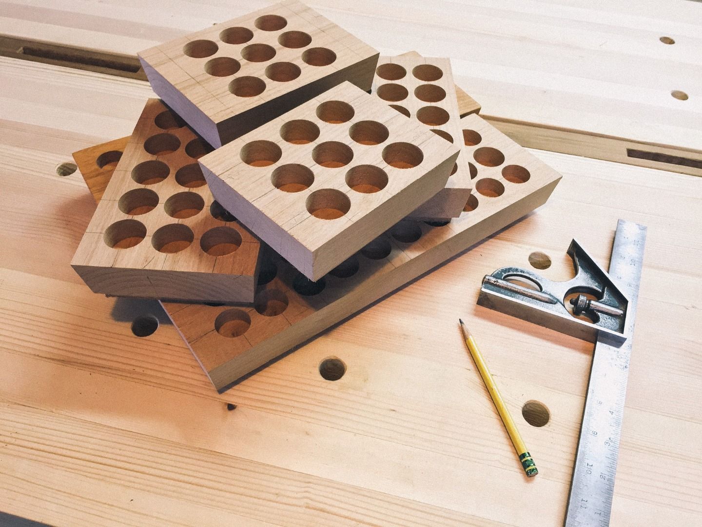

Step 3: Drilling the Holes
Now on to drilling the holes. I made each of these pieces a little different in size since this was my first batch. I wanted to find that perfect shape, and what a better way to find it than to practice on the poor people that bought the first round. In some cases, I tried staggered holes, even holes, room on the ends for easy carrying, long, short ...
Because of all the random sizing, this made measuring for the hole placement a nightmare. If all of them were the exact same, then it would be easy to mark all my holes again and again. I could even make a jig overlay and punch markers. But, in this case, this is where I spent most of my time. Just me, the radio and my pencil and ruler.
I drilled the holes about 3/4" deep. I wanted to still be able to read the labels on the side. I know most companies sell oil stickers that can go on the top, but to me, that's crazy talk.
I eventually got them all cut on the drill press and ready for sanding and finishing.
