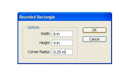

Step 9: Make the Postcard Shape
Leaving the spirals for a minute, create the shape of the postcard. I like a 6" x 4" card with 1/4" rounded corners.
Don't you?
Don't you?
