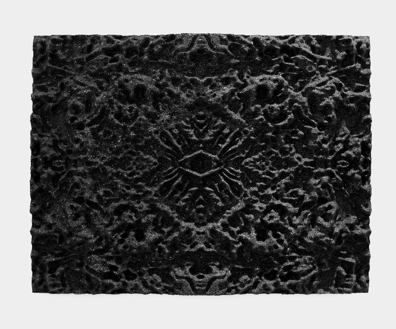

Material unpredictability can be just the kind of feedback you need in order to create something much richer and more compelling than your original idea. In my case, since the image became unreadable, I started paying closer attention to the texture of the stone to see if I could accentuate it. With further testing, I was getting interesting texture, but also noticing that some severe undercuts were happening as the waterjet was etching the material. This looked promising, so I decided to push the process still further.
Step 4: Tuning Inputs
As I mentioned, the question of how a material will behave when exposed to a particular process is really answered only by exposing it to that process. Through trial-and-error, I found that marble couldn't hold a high level of detail. I responded by reducing the detail in the input image considerably allowing the texture of the resulting etch to stand in for the high level of detail in the original image.

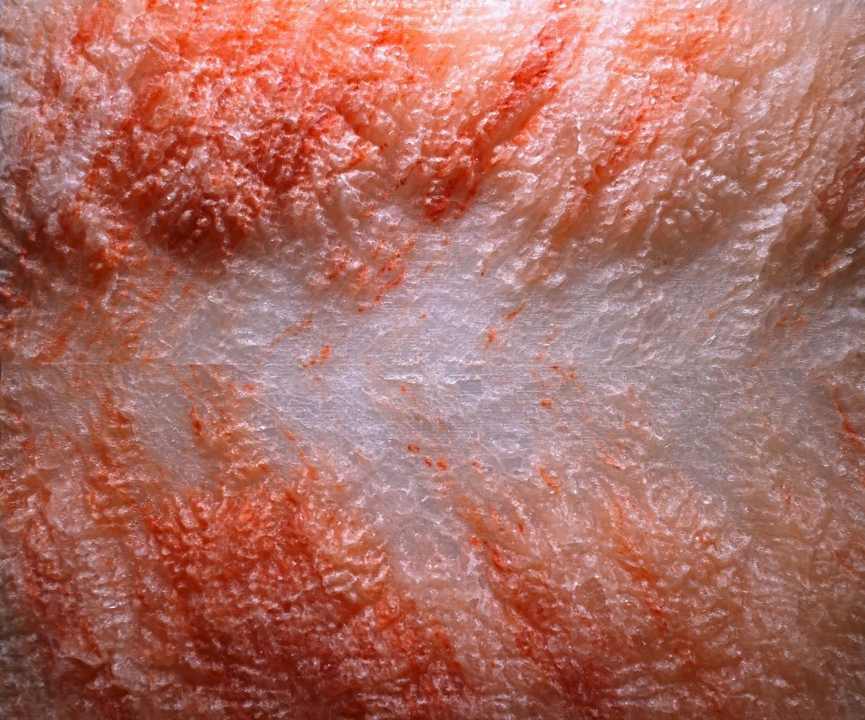

With the first etching operation complete, I lowered the water level and began flipping / rotating the piece. I had also accumulated a large pile of garnet to contend with. After rinsing off the excess garnet with a hose, I was able to lift the piece up off its registration pegs. As some of the pegs were stuck, I had to get another loose peg and tap them out with a mallet. Finally, I was able to rotate the piece 180 degrees and align it with the registration holes. Then I re-inserted my pegs, and was ready to begin the second etching pass.
Step 8: Etching Pass 02
With the registered flip complete, the last step was to run the final pass. One thing I would account for were I to perform the same etching again would be the overlap of the two passes near the panel's center. While I did nudge the path start home out a few hundredths of an inch to account for the kerf of the stream of water, the secondary bouncing & cutting etched deeper in this area than anywhere else on the panel.
