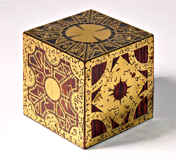

Thanks for the reply. What I had in mind was making a replica of the puzzle cube from the movie Hellraiser. The actual prop is a wooden cube with brass panels on all six sides. Opposing sides have similar, though subtly different designs. You can buy professional made replicas, but they're usually expensive. Besides, I thought it would neat to be able to make one myself for a relatively low cost.
http://vignette3.wikia.nocookie.net/cenobite/image...
I have a set of hi-res images of the panels which are suitable for printing at the sizes required (3"x3"x3" I think). Looking online, it seems that others have actually done this, although they're usually a little vague on the details.
Reply 7 years ago
Yeah, looking at that, it's certainly not going to work. There's no way you'll be able to get a fine enough detail on the etch, and the brass would have to be crazily thin - too thin to be workable for this method. It looks like you really would need something more like a gold leaf transfer for this.

Not so.
See here:
http://www.britmodeller.com/forums/index.php?/topi...
Reply 6 years ago
I stand corrected! That's pretty cool!
