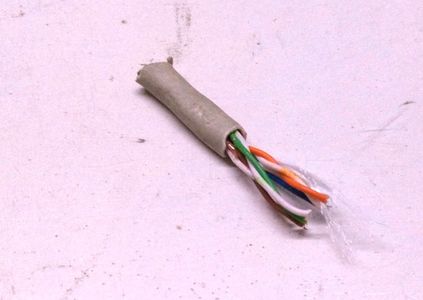

- prepare a 6 cm piece of the ethernet cable, removing external insulation cover
- separate each wire
- insert the individual wires in the slots of the jack, press them with the tool or its cover
- use another wire to connect the shield
- remove individual insulations at the other end of the wires

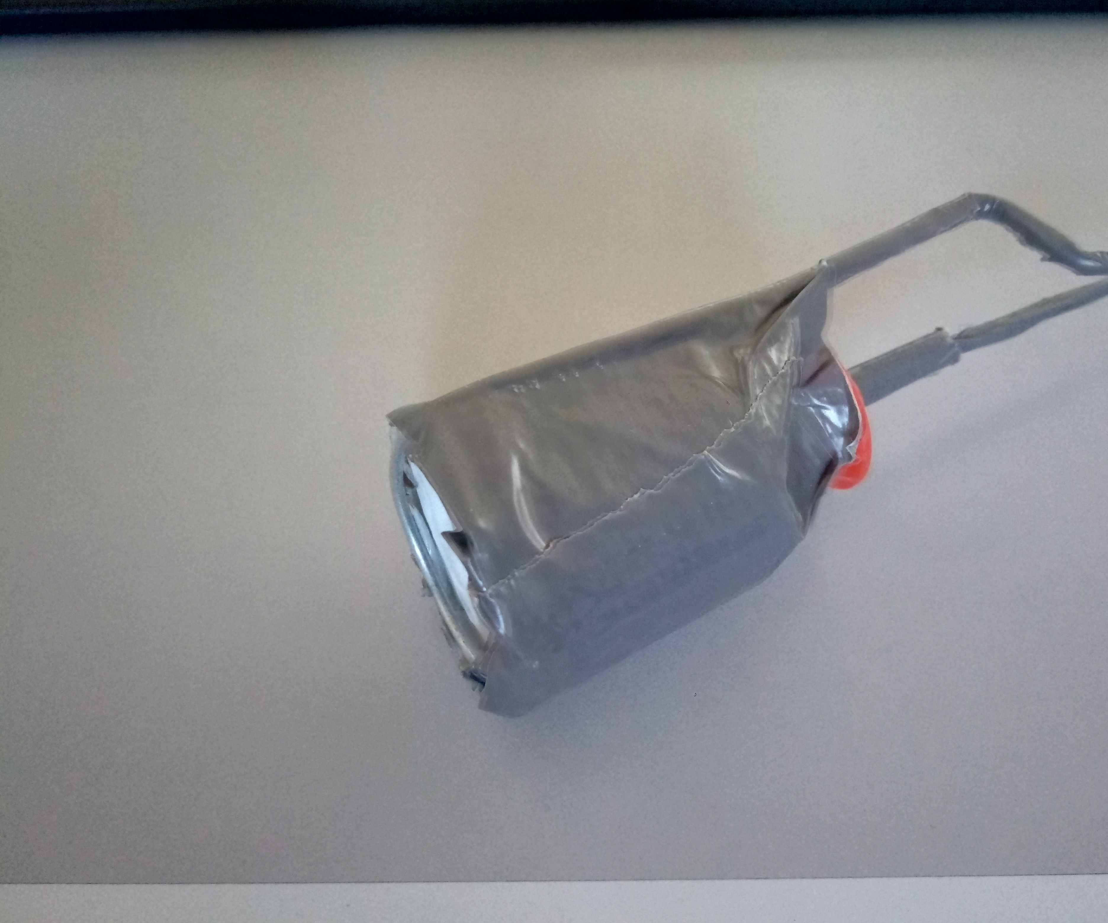

Step 3: Remote Terminal
This unit will be passive only, with only one female RJ45 connector on it, and all the resistors:
- cut a piece of breadboard a bit larger than the jack (let's say 10 holes), and twice longer (let's say 15 holes)
- take one of the already prepared sockets
- insert the wires from the jack into a strip of 8+1 holes, and solder them (if you used salvage connectors, insert the naked wires in as much as possible, in order to avoid short-circuit between them)
- trim the exceeding length of the wires
- use hot glue to fix jack and breadboard to each other, thus avoiding short circuits
- insert and solder the resistors according to the schematic
