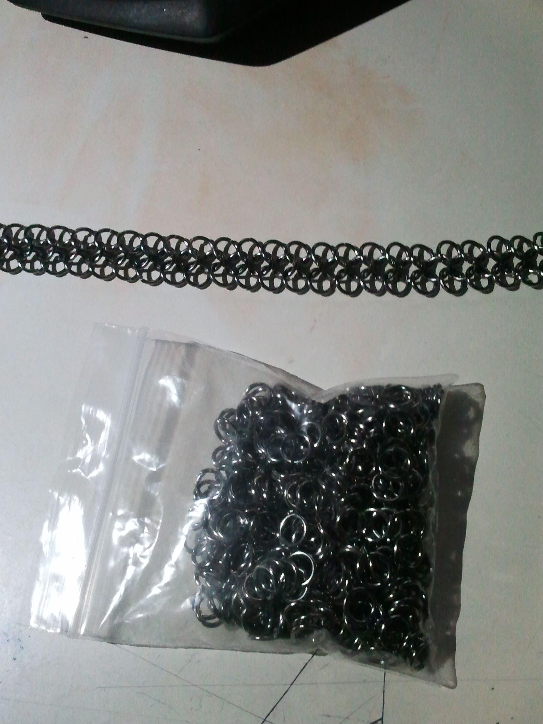

Equipment-
Two or more tie wraps/similar.
Cutting implement (you can do without)
Pliers two sets ideally (for bending rings)
Chainmail rings.
