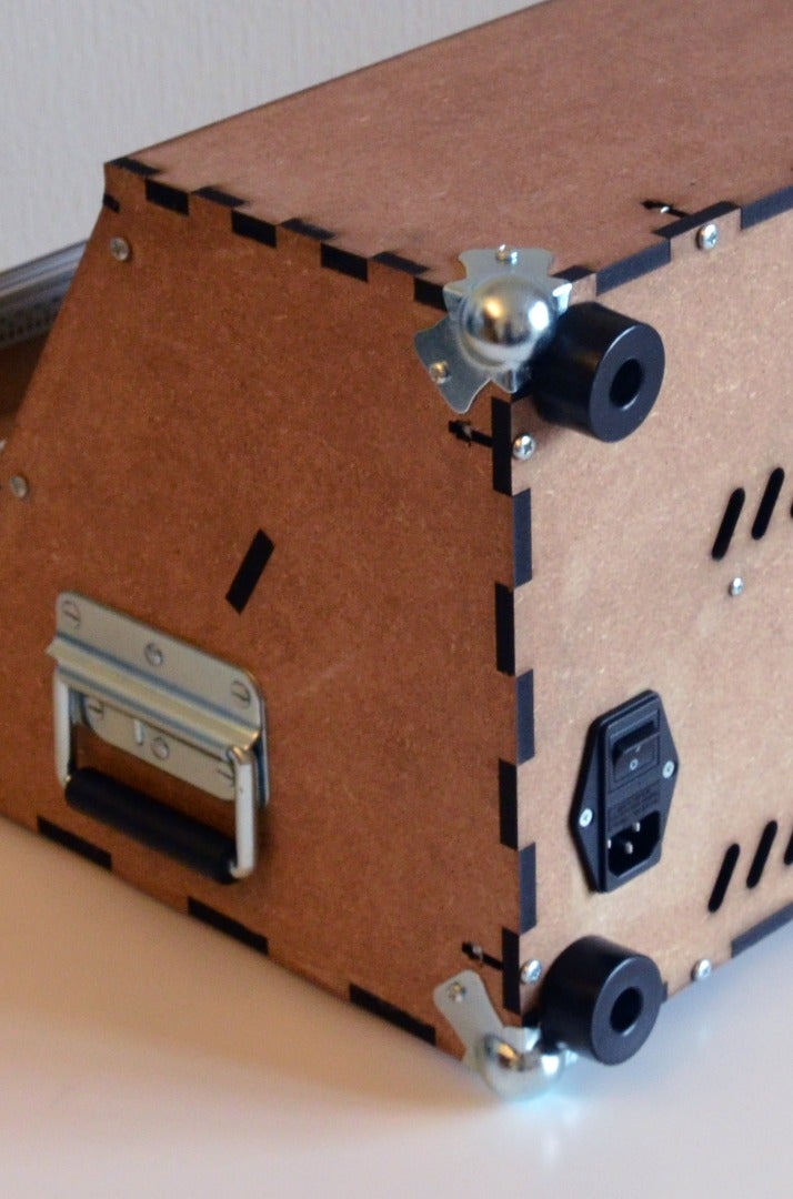

I needed a base for my eurorack modular synth. My requirements were: 3 rows of 84hp, and it should fit well right under my Doepfer A-100P9 case. I wanted to try laser cutting for some time. Moreover my local fablab offers free machine time for open hardware initiatives. This was the ideal project to test laser cutting!

Step 1: Cut It!
Cut your MDF board. Make sure you adjust the power/speed/frequency of the laser to produce nice, clean cut without to much burning before cutting all the pieces. The attached file contains a small test object you can cut to make sure the nuts will fit tightly in the mounting slots.
The laser cutter I used (Trotec 300) has a smaller working area than my biggest board (the bottom panel) so I had to split the bottom in two.

Step 2: Build It
Now it's time to assemble all the parts.
The case is designed to have a removable back for easier access to the power supply.
- screw the subrack rails to the side panels
- glue the front, bottom, sides and top together, holding everything together with clamps or vices. Make sure everything is tightly fitted when glueing.
Once everything is glued and dry, you should apply some varnish to protect the wood. It helps with the bad smell of laser cut MDF.

The power supply (Meanwell RT65B) and the power inlet are mounted to the inside of the back panel using M3x16 chamfered screws.
The mains power is connected to the power supply and the power supply outputs to the doepfer buses.
Step 4: Hardware
Last, the handles, metal corners and rubber feet are screwed to the case.
Now you just have to mount all the modules and voilà! here is your awesome eurorack base!
