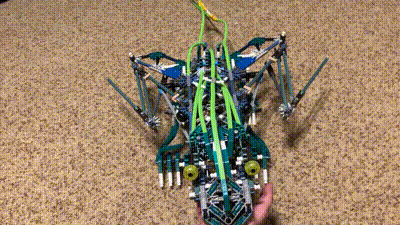

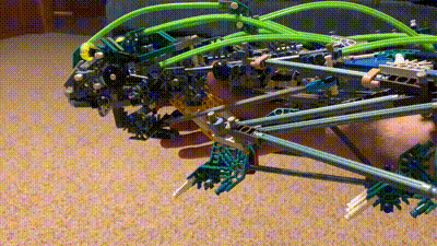

Introduction: Eustace the Dragon, a K'nex Dragon Puppet
There was a boy named Eustace Clarence Scrubb, and he almost deserved it.
This is not that boy, but I did name the final project after him because I love the Chronicles of Narnia series. This is a ventriloquism puppet I made a while back, left alone for a while, then came back and improved later. The current version includes a trigger-operated mouth, a three degree-of-freedom neck, two degree-of-freedom eye movement, and articulated opening wings. The entire system is designed so that it can be worn over the arm and so that all the moving parts can be operated simultaneously with one hand.
I hope you enjoy this.

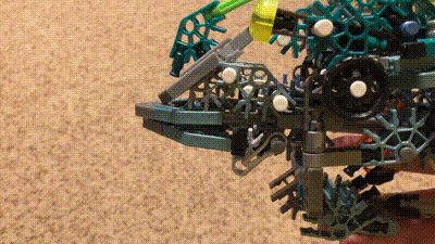

Step 2: Jaw
This is the lower section of the head, with the moving mouth and the attach point for the handle.
- These components will form the trigger linkage, which will connect the trigger to the mouth.
- Here is the assembled linkage. The white (silver) rod that doesn't have a blue rod attached to it will connect to the mouth.
- The linkage attaches to the head via an axle on a pair of gray two-slot connectors. The Y-clips on the connectors face away from mouth attach point.
- Here is the linkage with the assembled axle.
- Here is a front view of the linkage. As mentioned before, note that the gray connectors have Y-clips facing away from the front.
- This U-shape will form the lower jaw of the mouth.
- The Y-clips on the lower jaw attach to the ends of the blue rod. Normally, this type of connection is weak, but the other parts will hold it in place.
- The white (silver) rod connects between the two green connectors.
- Here is the top side of the lower jaw.
- The jaws will attach to an H-shaped frame made from two blue-purple (blue-silver) 3D connectors and seven white (two white, four silver, and a black) rods. The ones that are white in the photo will connect to the nose.
- The middle white (black) rod attaches between the purple (silver) connectors, and a yellow (dark gray) rod will connect opposite the two white rods.
- Here is the frame with all the parts attached.
- The Y-clips on the back of the axle will attach to the yellow (dark gray) rod on the frame. Both parts are shown upside-down.
- Here are the frame and lower jaw connected.
- Turn the assembly right-side-up to attach the upper jaw.
- The upper jaw is a U-shape similar to the lower one, but with a white (silver) rod already attached. The spacers shown are left over from earlier design experiments and are not necessary for this project.
- Here is the assembled mouth.
- This assembly will form the nose of the dragon.
- Here is a side view of the nose, to show how the green connectors attach.
- The green connectors will attach to the white rods on the frame.
- Here is the nose attached to the jaws.
- Here is a back view of the mouth and nose so far.
- A green connector with a Y-clip and a green rod will give the nose a bit more shape.
- Stick the Y-clip right in the center of the schnoz.
- The rods on the back of the jaw frame will attach to the frame on the handle, and the blue rod attaches to the trigger.
- Here is the mouth and nose connected to the handle.
- These connectors will attach the head to the neck later.
- The white (silver) rods on them will attach to the top of the rear frame connector on the handle as shown here.
- These two connectors will be needed for attaching the eyes in the next step.
- The green connectors slide onto the same rod that is used to attach the jaw axle.
- Rotating them up behind the fixed green connectors will temporarily hold them in place, but the connection is weak. It will be made stronger when the eyes are attached.
- Use a rubber band or an elastic string to hold the mouth closed. The best attach point I could find was the place where the mouth linkage attaches to the mouth, as this is fairly hidden once the design is complete, and it provides plenty of potential fixed points on the frame to anchor the rubber band or elastic string.
- This is the mouth and handle at the end of the step.

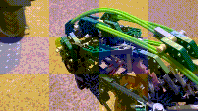

Step 4: Neck Joint and Upper Body
This is where the head connects to the rest of the body. The neck is essentially a universal joint mounted on top of a pinned hinge. The top of it attaches to the back of the head to form the upper body. The bottom will connect to the lower frame of the body.
- The upper universal joint is made from a blue and purple (blue and silver) 3D connector surrounded by 4 white rods. The red (dark gray) connector is needed for stability.
- The center of the joint is a white connector surrounded by 4 green rods.
- The center plate is placed under the center of the 3D connector, and the two side connectors are slid over the green rods.
- Two silver spacers are used to keep the connectors from sliding back off the center plate. They are held in place by the frame, which starts with four 3D connectors and two blue rods.
- The connectors form an hourglass-shaped frame.
- A blue rod fits on the side opposite the red (dark gray) connector with a pair of orange (brown) connectors on it.
- A pair of gray two-slot connectors with green rods on them connect to the back of the frame.
- Just like the ears earlier, these black domes are optional and can be skipped.
- The open end on the front of the frame connect to the blue rods on the back of the head.
- Another blue rod slides through the holes in the gray connectors on the back of the top of the head.
- This rod attaches to the frame to complete the square.
- This is a gray one-slot connector and a gray two-slot connector attached to a couple green connectors by a pair of white rods.
- The white (silver) rod on the back of this assembly attaches to the 3D connector in the center of the frame.
- A total of five purple (green) flex-rods will add texture to the back of the head.
- Two of the flex-rods attach to the green connectors behind the eyes.
- The other end of those connectors attaches to the gray connectors on the back.
- This is the back with those two flex rods attached.
- Two more flex-rods attach to the green connectors on top of the head.
- These attach to the orange (brown) connectors on the back.
- The last flex-rod attaches between the green connector on the nose and the gray connector in the center of the back.
- Turn the model upside-down for this next step.
- The red (dark gray) connector with white (silver and black) rods will stabilize the universal joint.
- Attach the stabilizer to the frame as shown.
- This is the other side of the universal joint for the neck. A blue or tan clip could be used in place of the black disk, but the disk works much better.
- The silver spacers and tan clips will hold the universal joint together on this end.
- Here is the joint with the spacers and clips attached.
- The frame here will attach to the lower part of the body.
- The blue spacer fits over the rod on the bottom of the universal joint.
- The frame fits over the blue spacer. This will sit directly on top of your arm, so you will want to use a black disk here instead of a clip.
- Here is what the project will look like at the end of this stage. The eyes and mouth should be usable at this point.

Here are what the different controls do and how to operate them.
- Operating the mouth simply consists of pulling and releasing the trigger with the index finger.
- To move the eyes, press your thumb into the back of the 3D connector above the handle. The eyes move in the opposite direction from the connector, so pulling it down moves the eyes up, pushing it to the left moves them to the right, etc. One flex-rod is removed in the video to make the thumb easier to see.
- The wings are controlled by the lever under the chin. Pushing it forwards extends them, and pulling it back retracts them.
