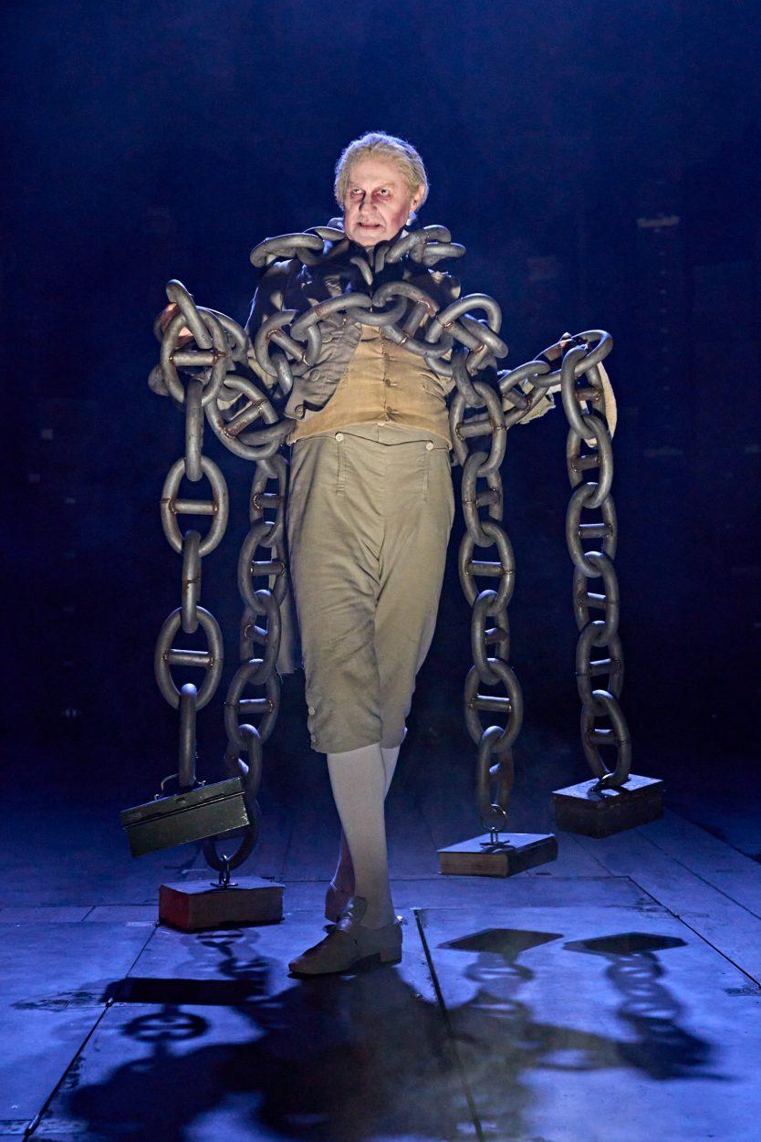

I was tasked to make the chains for the character of Jacob Marley for Nottingham Playhouse's 2021 production of A Christmas carol. The shows designer requested very large links akin to those in the iconic photograph of Isambard Kingdom Brunel. At that size in metal they would have broken our actor even if he could have lifted them so we went with making them out of closed cell foam.

I went for a raw iron and slight rusting. the paint I recommend is clear Hex-flex form Poly-props in the UK. Mixed with stranded acrylic paint. Hex-fex is designed to bond to foam and was great in not sticking to itself which would have been horrible when painting a props such as chain when there are always parts touching on another.
I also painted the clear Hex-flex on to the areas I wanted t be rusty, sprinkling iron filing onto these areas whist still wet, once dry I wet then with salt water so the rust would oxidize naturally. If I wanted I could have done this all over to make completely rusty chains.
for the weld lines I simply pumped in silver hot glue and then washed over this with some rusty brown paint to take the shine off.
Step 6: Finish.

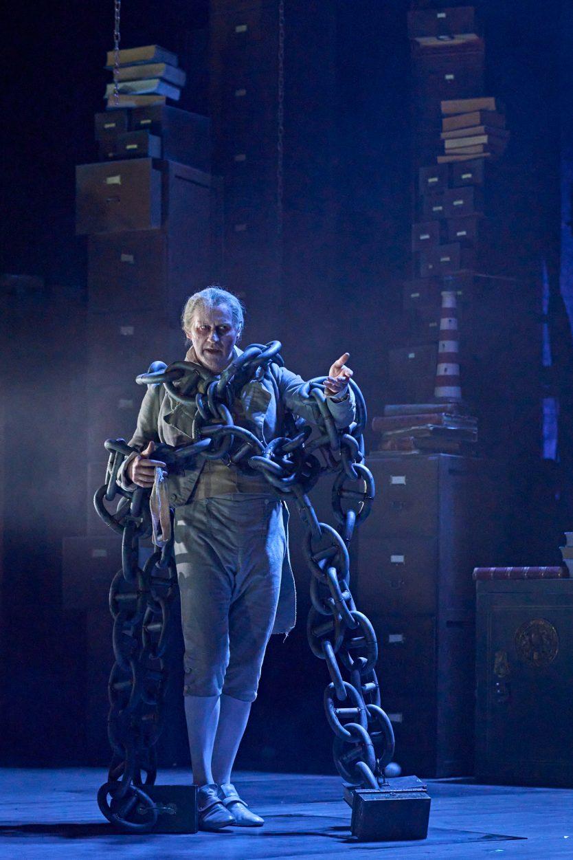

Next I cut and draped over a a manikin and a volunteer (Paul the designer) and handed over to the wardrobe department to fit to the rest of the costume and the actor.
