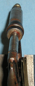

Visually, this micrometer has a few issues, good and bad. The paint is worn, but there are no dents or dings that imply that the tool was dropped. The damaged ratchet speeder is not making for a warm, fuzzy feeling, but the thimble itself appears undamaged, so it isn't a big worry. The speeder sticks out and they are relatively vulnerable. The manufacturers sell replacements.
The indicating edge of the thimble isn't dented and is concentric to the barrel, so the thimble and spindle end are probably not bent. Though the measuring faces can't be brought into contact due to rust, they are not visibly misaligned. If I could bring them together, I would look for alignment of the spindle with the anvil and see if the faces meet plane-to-plane. Any gap or unevenness in the meet is a negative. Any indication that the frame is bent is an instant rejection.
The big concern is the rust. There is a little on the faces, spotting on the spindle surface, and the spindle is frozen, making the tactile examination simple. The rust on the thimble doesn't matter as long as there isn't heavy pitting.

This is mostly time. Just time. Oh, and penetrating oil.
Penetrating oils do a great job for this type of work. Rust removal chemicals (derusters, rust converters, naval jelly, acids, lye, etc) and electrolysis should NOT be used.They are much more likely to change the dimensions by removing excess material or growing a surface than a simple penetrating oil. Some of the "magic" penetrating solutions have corrosive properties and can damage precision surfaces. The goal is to not ruin the precision of the tool.
I supported the frame in small vise with some paper to soften the grip (the vise was snug, not tight) so that the spindle was straight up and down.
Then, a drop or two of penetrating oil at the top to get things started. Gravity and capillary action did the work. As the oil works in, another drop. No rush. No oil goes anywhere else. We don't want to trap air or, worse, water in there between two seals made of oil, do we?
When oil showed up at the locking ring, I added a few drops there, and not long after, it worked through the last bit.
While the oil was soaking through, light rotation of the spindle helps, like with any stuck screw. Even if it doesn't move, the force can help open up microscopic gaps that let capillary action do it thing. No tools for this. Just fingers.
It wasn't needed here, but, if the penetrating oil doesn't get through in a few days, a little heat can help. The oil is flammable, so flames are out, but any ignition safe heat source that can be used to quickly warm the barrel an frame where the spindle go through up to maybe 80 or 100 degrees (175 to 212F) will help open up gaps. The frame and thimble will grow from the heat sooner than the spindle.
Once the oil worked through and the spindle, begrudgingly, began to free up, I ran it in, not out. Running it in provides the shortest path for getting at least some of the rust out, without dragging it through the threads that give the tool its precision. After several minutes working the threads back and forth, the spindle advanced until it just about met the anvil, and I was able to clean off a lot of the rust. No abrasive, just lint free wipes and brown paper.

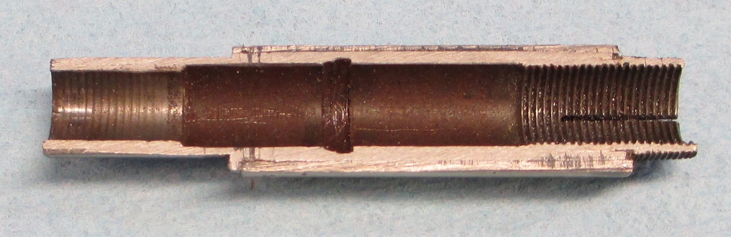

Once the spindle was substantially free and as much rust was off as practical, little light machine oil was applied to the exposed spindle and the and then the spindle was unthreaded from the frame. As it was removed, there was no binding or rough spots. If there had been, then those are the places to stop, put a little oil on the threads, and run it back in. The key thing is minimal force. It should come out freely. Once out, it was cleaned to remove the last of the rust using the same lint free cloth and brown paper technique. The threads were clean, so not a big deal.
If there had been rust on the threads, then that would have been the end of the job. Rusty threads make it impractical to repair, as it will never operate smoothly and accurately.
Once the spindle was removed, the lock was removed. On this model, it slides straight out of away from the frame. The keyway at the front of the frame. The assemble comes out as a unit, and may require a little finesse. The lock has a spring cut in it so it has friction to hold it in the frame slot. I generally use a small blade type screwdriver as a wedge behind the lock ring. The target is straight out without cocking the key in the keyway. A little care prevents loss of the lock roller.

After thorough cleaning and drying of all parts, the spindle was test fit to check the thread fit. If it didn't go in dead freely, then the fingers for the wear adjustment could be gently spread using a small screwdriver in the gaps. This must be done carefully, as if they are not spread evenly, the spindle may not be properly aligned. In this case, the spindle was free.
The adjuster ring was put back on- it has a taper in the threads, so goes on the right way much more readily than the other- and adjusted a fraction of a turn at a time until there was no detectable play in the spindle. It turned freely through the entire range with no play, so the adjustment was good and thread wear is not an issue.
The spindle was removed and the lock ring reinserted. The same spring slit that makes it awkward to remove makes insertion a tender job. Be sure the key is aligned to go in the slot, the assembly is lined with the center of the frame, and press it in. It may take a little force. Watch through the bore for alignment. It probably won't line up right, but get it close. Do not turn the ring, or the lock may compress making spindle insertion impossible.
