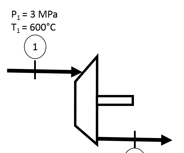

Before we get to identifying values, I will briefly explain the diagram. The trapezoid represents the turbine, and the rectangle coming out of the trapezoid represents the power generation component of the turbine. The arrows represent the flow of the water through the turbine. This is a fairly standard diagram method used throughout thermodynamics.
