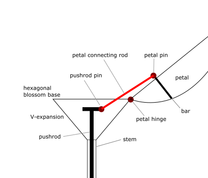

Step 6: Petals Mechanism (6h)
This is the part you gonna regret you ever started making the flower in the first place. I almost throw it into the trash once. But hey, I am not the most patient guy ever. You are gonna nail it! For this part, I've got inspired by steam engines and their rods, pistons, and flywheels.
Make yourself a test stand. Fix the flower with the stem in an upward position. Put the pushrod through the stem with its head upward. Solder short tubing perpendicular to the bottom end of the pushrod and create yourself a small connecting rod out of 1mm brass wire to connect servo and the pushrod (see the picture above). You should be able to move with pushrod up and down using a servo. Try it by hooking up your Arduino. Before you can start soldering the connecting rods between petals and pushrod head you need to tune up the servo movement with Arduino. Write your code to move pushrod up and down in a way when in the topmost position the pushrod head end is flush with blossom hexagonal base. And in the lowest position, it sits on the bottom of the blossom V-shaped base.
Tip: Use Adafruit_TiCoServo library to control the servo. It will allow you later to control NeoPixels at the same time as the servo.
Tip: To make your pushrod movement is as soft as possible, use the hole closest to the center of the servo arm. The servo will need to spin longer but with shorter steps.
This is an animation of how the pushrod moves with petals. As the pushrod moves up it pushes the connecting rod and petals down. As it moves down it drags connecting rods and petals are being closed.
Petals are currently missing one crucial part - petal pin. This hinge makes the petals move. The hinge sits on a bar (see image above) which is soldered to each petal parallel to its base. Petal pin needs to be above the surface of the petal in order to allow it to fully open as you can see on the animation. Make yourself one such bar with a hinge from tubing and solder it to the first petal. This will need a lot of experimenting with the size of the bar and its distance from the petal base to allow the pushrod to fully open and close the petal. Use trial and error method. Solder the bar to a suitable position and add connecting rod between the pushrod pin and the petal pin. If you have your pushrod in the upper position and your petal in a fully opened position, space between pushrod pin and petal pin is the length of the connecting rod.
Now try to move with pushrod up and down to see what is happening. If it works fine without any rubbing and petal can be closed and opened you are done (with the first petal)! If not, try a different length of connecting rod or different position of the bar. In order to finish the blossom, duplicate the same bar and connecting rod on each of the 5 remaining petals. The 3 outer petals need to be a little lower when the blossom is opened to allow them to properly overlap the inner petals while closing. In the end, you should be able to close and open the blossom. Don't panic if you failed to do the perfect shape for the first try. It only means all the petals are not perfectly the same. It will probably take a lot of fine-tuning to create a perfect shape - slightly different lengths of connecting rods and positions of bars. Take your time here! A reward is near.
