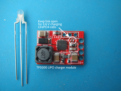

Charging Module 1 TP5000 Module

The solar panel is rated at 5v 100mA and this is used to trickle charge the batteries throughout the day (as the radio is located on the windowsill of my bathroom, it has strong sunlight in the morning). A TP5000 module is used to charge the batteries as it has the option to charge LiFePO4 cells up to the maximum of 3.6 volts (just leave the contact pads unsoldered - see the picture).

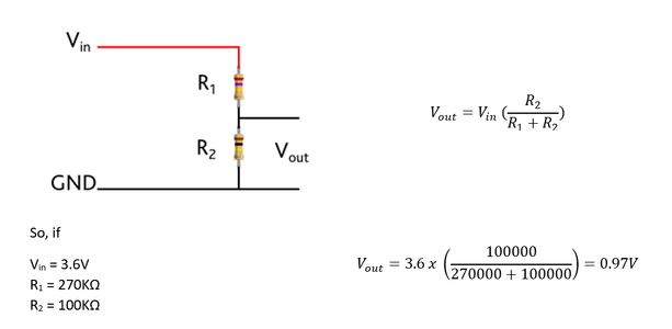

I was conscious to remove any drain on the batteries to preserve their maximum capacity. I may have been over cautious, but I did not include the illumination on the on/off switch for this reason. Also, the TP5000 included a bi-colour LED to show when the batteries were charging or when they had reached the correct voltage. This was useful during the testing period, but I decided to leave it out of the final design as I knew that the charging module was working and I was able to measure the battery voltage directly using the ADC to see the state of charge.

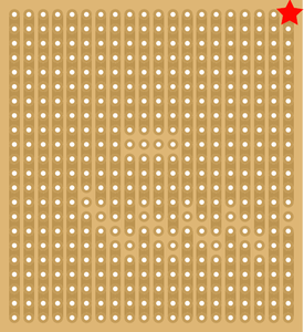

Step 9: Stripboard Manufacture
The stripboard (20 columns x 23 rows) needs to have cuts made to isolate each of the components. The easiest way to do this is to use a 3.5mm drill to gently break the track. You can twist the drill between your fingers to ensure you only cut the track as far as necessary. The images above has a red star on the corner as a point of reference.
