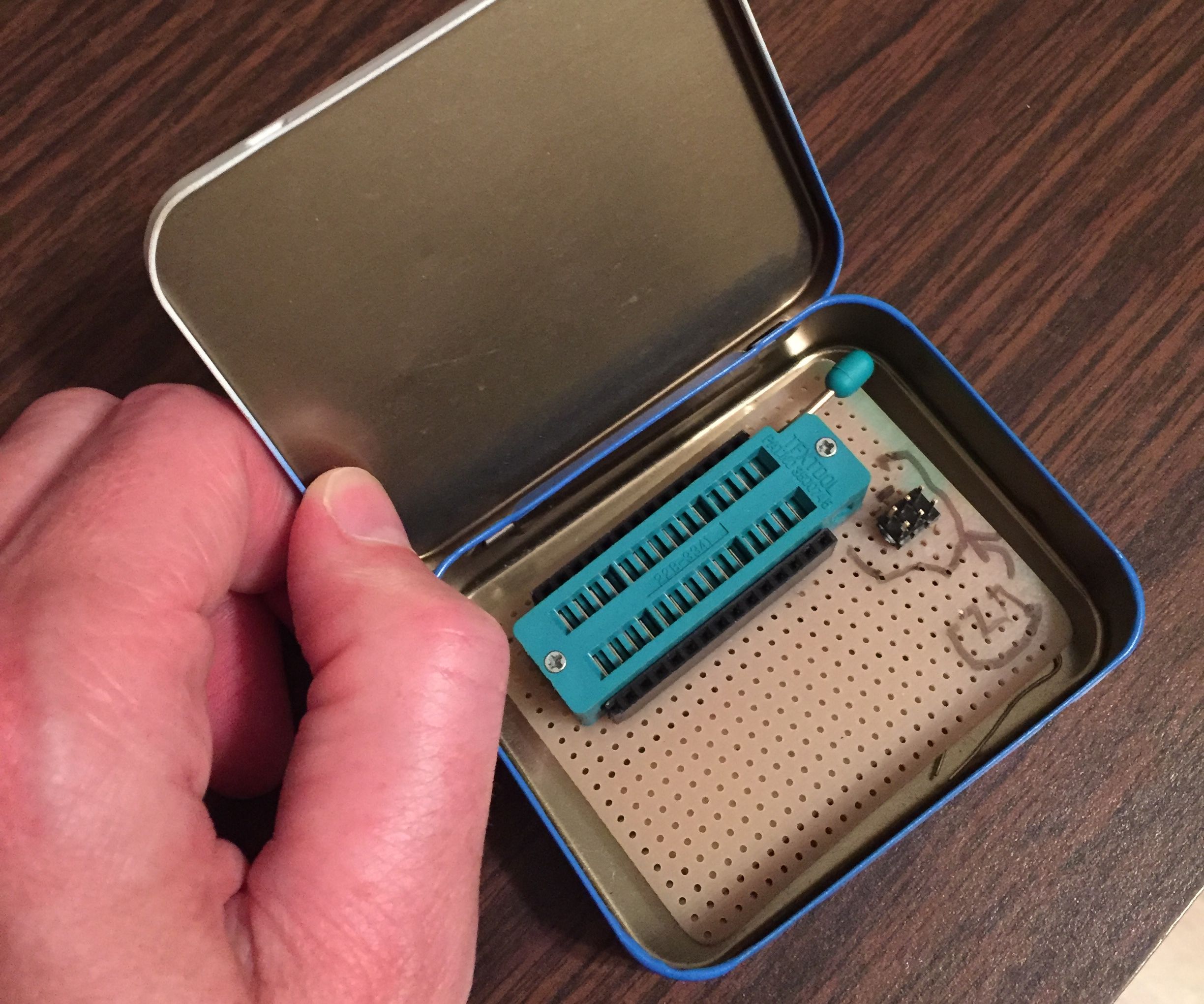

Step 2: Inspiration and Preparation
This project was very heavily inspired by the 1-Key-Keyboard. It uses the V-USB library to simulate a USB device which sends a character (or string of characters, think password or ‘randomly selected synonyms for ‘cool’’, or such) to the computer when you press a button.
I wanted to simulate pressing the 'up' button every 7 minutes to keep the computer awake. I still included the button in my circuit. Why? Because then all I have to do is push that button to verify the device is ‘alive’ in the event I need to do some troubleshooting. Also, who knows? Maybe you want to program it to send a char or string of chars in addition to its periodic pinging.
Take your USB device and cut the cable. Leave a couple of inches so you can strip the wires and run the cable from the board through a hole in the tin. Probably best not to leave the cable too long.
Strip the wires making up the USB interface. There will be a red, black, green, and white wire.
Drill a hole in the center on one side of the tin that's wide enough that your cable can pass through it.
Cut the PCB down to size: (about 2" x 2 3/4"). You can do this with a bandsaw or a dremel, whatever you have handy.
Heat up your soldering iron.
Step 3: Assembly
My circuit is a simplified version of the one on the V-USB page (see the circuit diagram above). I didn't have luck getting two diodes to drop the voltage from 5 to 3.3, so I swapped those out for an LD33 Voltage regulator. Additionally, thanks to some things I learned from the '1 Key USB Keyboard' page, fuse settings plus things you do in the code make the crystal and 2 associated capacitors unnecessary. More about that in the next step.
The circuit I ended up with is illustrated in the colorful Fritzing breadboard diagram above. You can use it and the image of the finished project to guide you in soldering it together on the PCB. A sort-of tricky bit is soldering the leads from the cable to the board after running the cable through the hole in the tin, so do this last.
Refrain from attaching the board to the tin with double-sided tape until you've had a chance to ensure everything works fine. You will need to put some insulator like paper in the tin to prevent the board from shorting out connections when it comes in contact with the tin.
I like using hot glue liberally whenever I have the opportunity. In this case it secured the cable (and the somewhat fragile wires from the USB cable) and I spread it over exposed solder and what not.
