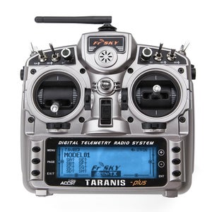

Step 3: RC Transmitter
There are many things to know about the transmitter, there is a big difference between the chipper ones and the expensive ones... there are modules you can add for improved range, there are some that can talk back to you and warn you about stuff related to the drone, signal lost, for example, there is a different feel to the gimbles and their accuracy...
Now, I have only flown with the chipper ones, at first I have flown with an unknown transmitter - Then I bought a second hand RadioLink and now I mostly use the FlySky which is the most capable chip transmitter, however, im having a range issue with it and recently ordered the Jumper T16.
What you should know is that
- You must have at list 6 channels.
- There are different kinds of transmitters - Mode 1, Mode 2 etc., What the mode means is where the Throttle stick is on the transmitter, left or right, now you probably think you should have it on your dominant hand, well...maybe... but you should know that most of the drone pilots use mode 2 and if you chose something else might be discovered later as a difficulty, and unlearning something you got used to might be lot harder.
- Currently, the most used transmitter is the FrSky Taranis X9D but lately, it becoming a smarter choice to get the Jumper T16.
Also, there is a fight between those companies (FrSky and Jumper)
* Mode 2 has the throttle on the left stick along with yaw and pitch and roll on the right stick.
** Pay attention to which mode you are buying, changing a mode of the transmitter is difficult to impossible

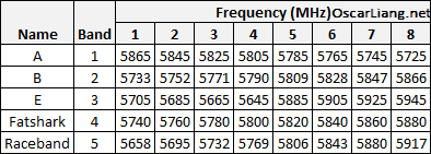

Step 11: VTX - Video Transmitter
Here it might get complicated because there are all sort of features that can be added on the VTX (video transmitter), such as Smart Audio, that is out of the scope of this Instructable.
The VTX is connected to VCC (according to the V rating on it - usually 5V) and GND and to the VO (Video Out) on the Flight Controller (FC).
It takes the video generated from the camera, added the OSD (On Screen Display) from the FC and transmit it through the air to the goggles through which you see (Make sure the VTX and the goggles are on the same channel)
Starting with a good enough VTX is very important since you can manage with other stuff not begin the best but not seeing where you are flying is frustrating and problematic.
I tried lots of cheap no good VTX that got me to crush and stuck on trees...
Eventually, I got the Eachine 805 VTX wich turned out to be quite good and not too expansive.
You should take notice of the Antenna connector eather SMA or RP-SMA, The antenna you'd need is either one or the other.
Most use RP-SMA
