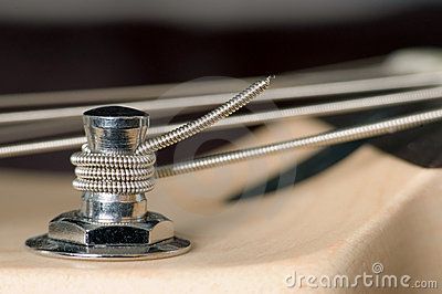

- Insert the string through the appropriate tuning peg, and pull it relatively tight; if you're using locking tuners, pull it as tight as you can, otherwise, leave a little bit of slack
Note: Even with locking tuners, you're going to get a bit of slippage, especially on the thinner strings; I've found I need to leave a little extra on string 1, enough to wrap a couple times, to prevent the string slipping out altogether (your mileage may vary, depending on the tuners you have). - Tighten the string by turning the tuning peg key; the direction depends on which side of the headstock the tuner is installed on--if on the left side, turn it away from the bridge, and on the right, towards the bridge (you want the string to be as straight a line as possible from nut slot to tuner)
- On non-locking tuners, bend the extra bit of string so it points straight up after emerging from the tuning peg; as you wind, you want the loops to trap this part of the string in place; see the diagram for specifics
