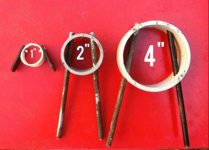

Introduction: Evolution of PVC Clamp
I started with a feasibility study of making a clamp from PVC pipe here: https://www.instructables.com/id/DIY-PVC-Clamp/
When I published that I'ble, I found there were other Instructables about PVC clamps, but they all required 2 hands to use the clamps. That's not always an easy option, since your other hand is holding the pieces you want clamped.
This is my third version, and it only requires 1 hand to use. Let me show you how it's made.

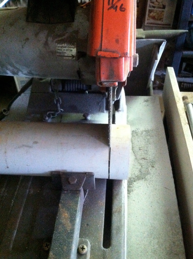

Step 2: CUT PIPE
Cut the 4" PVC pipe into a 1.25" band. I used a chop saw.

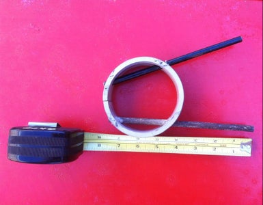

Step 5: FINISHED
I put a tape in the first photo for perspective on size.

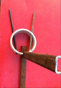

2nd photo shows some metal to be clamped.
Last shows pieces clamped together.
This clamp is quiet strong, but can still be opened with one hand.
If you have any questions, just ask in comments.

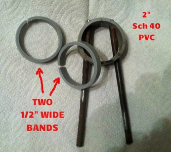

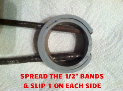

Step 6: MAKE THEM STRONGER
I found I could add 2 - 1/2" bands to increase the clamping power of the clamps. This 2" clamp now has more holding power than a 4" clamp.
