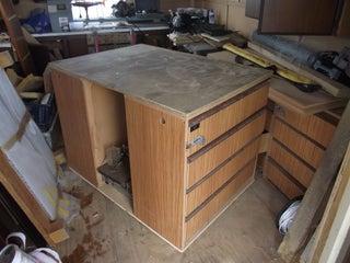

I bought 4 chest of drawers from work for $5 a set, I used 2 in this bench
They are nothing special, MDF but are pretty robust
The first thing that I did was bolt them down onto a piece of 3/4 plywood and screw another piece on top, I left a kneehole gap between the 2 sets of drawers and added wheels to the base
The wheels were from a display unit that was being thrown away at work, the 3/4 plywood was rescued from a skip
The top is approx 1200x800mm
So total cost up to this point $10 plus a few screws
It stayed like this for a couple of months, just being used for storage and as an assembly area

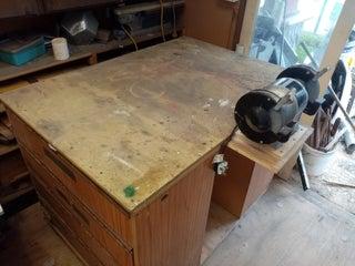

Step 3: First Modification

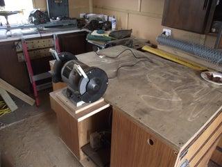

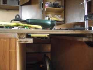

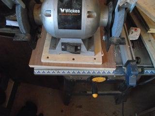

I wanted to use my bench grinder but realised that if I bolted it to the worktop I would be compromising my workspace
I made a couple of cleats and added a base to the grinder so that it can quickly be installed in a working position and then stowed away in the kneehole when not needed
Again it stayed like this for a while and in the meantime I bought more tools and space became an issue once again

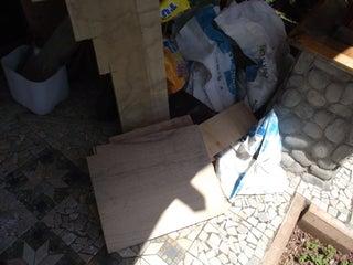

Those of you who have read some of my other Instructables will know I hate stuff being thrown away and going to landfill.
Well in another skip I found several decent sized pieces of really good quality plywood, when I "liberated" it I had no idea what I would use it for, but free is free!

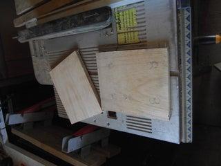

Step 5: Grinder Base

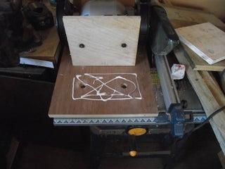

I cut 2 pieces of 5/8 ply to suit the base size of my grinder, obviously size will vary depending on what tools you are going to stow.

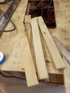

Step 6: The Runners (or Cleats If You Prefer)
I ripped 2 pieces of 60mm wide and 2 pieces of 30mm wide 3/4 ply the same width as my bench
Glued and screwed them together and set aside to dry

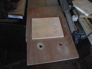

Step 7: Baseboard
Ripped another piece of 3/4 ply the width minus 60mm of the kneehole in my bench by half the bench width
Also shown is one of the bases which I bopped a couple of holes through
I continued the holes through the baseboard and then opened them up as clearance holes for nuts (later!)
Step 8: Securing the "tool"
I bolted the base to the grinder (in this case) and then glued and screwed it to the larger baseboard
Step 9: Attach the Cleats/runners
attached the cleats to the underside of the worktop and screwed in place, sorry not the clearest of photos but I think it can be made out.
This was a bit fiddly trying to get the clamps on by myself but managed it, I also trial fitted the baseboards to make sure they would fit and slide
Step 10: Grinder Ready to Go
All glued and screwed

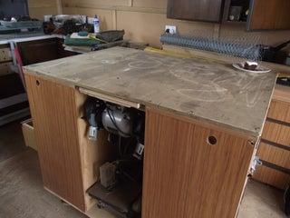

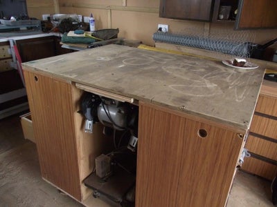

Step 11: And There It Is
So first picture is the working position, and second in the stored position, I will probably drill a hole and put a drop nose pin or bolt through to ensure it stays in position when working.

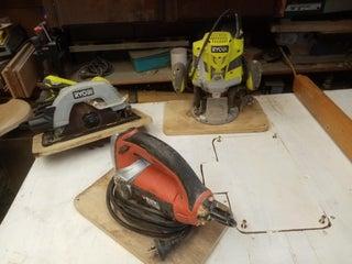

I saw a video that had all the most useful powertools mounted on pieces of wood so that they could be slotted in to the top of a custom built workbench, and thought that I could probably modify mine to do this
I cut a recess in the bench top and made inserts for a circular saw, a router and a jigsaw
Again all the plywood was scrap
I also made a saw fence from a sash clamp that i modded (cut off the end and welded it) this was also found in a skip, it had been thrown away as the sliding jaw was broken, I added hardwood "side runners" from some scrap moldings that were being thrown away at work from a kitchen refurb

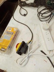

I also wired in a 4 socket powerboard and an Emergency Stop Push
I also made stowage cleats for all 3 tools so once again they fit in the kneehole (which is getting a bit crowded now)

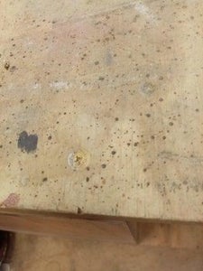

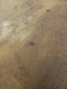

Step 14: Cleaning Up the Top
First thing I did was take all the top screws out, countersink all the holes and then put them back
Then I sanded the whole top work surface so all the detritus from the 3+ years I had been working on it was gone and I had a nice smooth, level work surface.

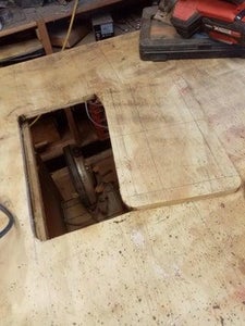

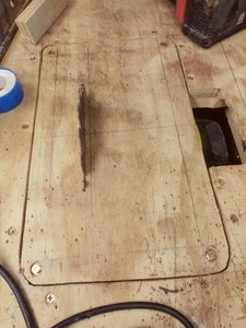

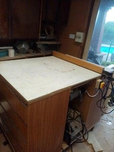

Step 15: A Bit of Marking Out

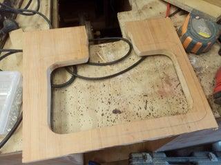

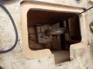

After checking that the knee hole was going to be big enough for what I wanted, I marked out the section I wanted to remove
Step 16: Infilling the Recess
Now they say that "the man who never made a mistake never made anything"
Initially I ripped 4 narrow pieces to screw underneath the hole for the cutout to rest on but it quickly became apparent that this wouldn't work so a rethink was needed
Step 17: Cutting
Sometimes you just have to commit
So using my battery circular saw I "plunge cut" the 4 straight edges of the part I wanted to remove (this will be used as a tool base and template for the other tool bases later)
I completed the curved corners using my jigsaw

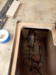

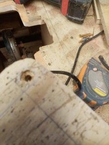

Step 18: The Rethink
I cut a continuous piece from some scrap mdf and screwed it into place underneath the recess
I also extended the hole with a side recess cutout in order to facilitate the circular saw motor
Step 19: Rivnuts
I had "borrowed" the rivnut machine from my work and drilled a hole in each corner of the infill support piece to accept an M5 rivnut.
Note at a later date I changed these to M8 as they were stronger

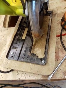

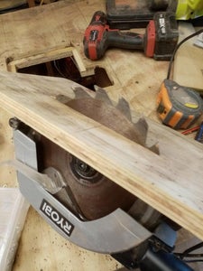

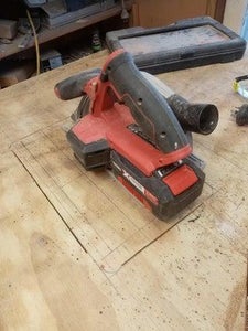

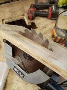

Step 20: Mounting the Circular Saw on Its Base
Using the original cut out from the bench top
I bolted my circular saw to it and then cut through (plunge cut) to give a zero clearance slot for the blade
The whole lot was then drilled in eack corner (from underneath) the the holes countersunk and the circular saw assembly bolted into place
I may fit a blade guard and riving knife later, but they are not essential (or compulsory in NZ)

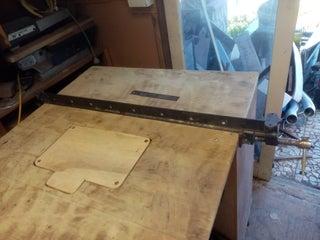

Step 21: Infilling
An infill blank was made to fill the hole when I just required a work bench. I also painted the work surface white.

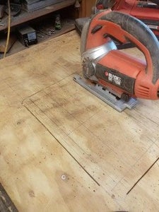

Step 22: Other Tools
The same/similar process was undertaken for the jigsaw and router

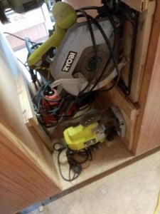

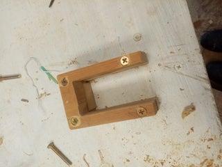

Step 23: Storing the Tools When Not in Use
I made a couple of cleats to store the tools in the knee hole when not in use, fortunately I used the strips that I originally ripped in step 5, so no harm, no foul

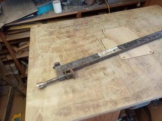

Step 24: Saw Fence

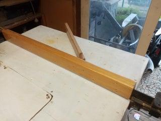

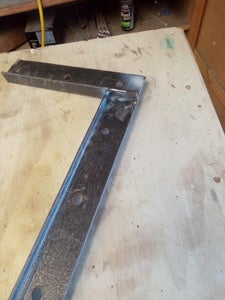

I found, once again in a skip, an old sash clamp.
It's sliding jaw was missing but perfect for me
I cut the end off and rewelded it at right angles to make a moveable fence
Using an old bolt I made a new tightening handle
I then cut 2 pieces of wood to go either sideand screwed them into position
These were pieces of dado rail rescued from the refurbishment of an office at work, so free.
The fence can be used on either side of the blade/router

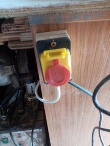

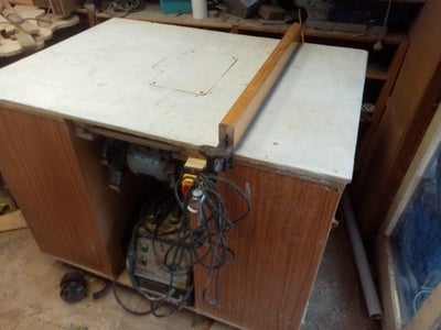

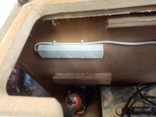

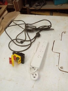

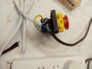

Step 25: Wiring It Up
Now safety first
In order for most of the tools to work I'm going to have to override the 2 step starting (where you have to press in a release before the trigger will operate)
This is easy enough (and easily removed again by using zip ties)
The tools are plugged into a power board (extension lead) which is mounted inside the nook and is wired to a cut off switch (emergency stop) and then to the regular power supply
Unfortunately I ran out of spade connectors for the emergency stop so will rewire it later when I can buy some more, but I managed to temporarily wire it to test that it all functions correctly (it does, the green button starts the tools and the red stops them!)
Step 26: The Emergency Stop Mount
Originally I was going to flush mount the emergency stop, but that would compromise the drawers sliding, so I made a couple of packers to allow it to stand proud
Then I screwed the stop switch and packers to the side
Step 27: And Completed
Ready for some "Hot Tool Action"
I may mark the top with ruler measurements for simple quick alignment of the saw fence

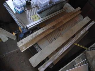

Step 31: A Bench Vise
I wanted a carpenters bench vise , but they are hideously expensive and also I didn't want it sticking out the side too far or impeding the use of the benchtop
I had been given several pieces of "L" section hardwood molding (again from the kitchen refurb at work and thought I could make those work
Firstly I cut 2 pieces down to the length of the bench (approx 1200mm) and cut a piece of 3/4 ply to the same length and 70mm wide
I then glued and screwed the 2 moldings to the ply leaving a small gap(big enough for the shaft of an F clamp to fit) and a larger recess behind it for the clamp head
The assembly was then screwed to the sides of the chest of drawers from the inside (after removing the drawers)
Running total $94.90 still
