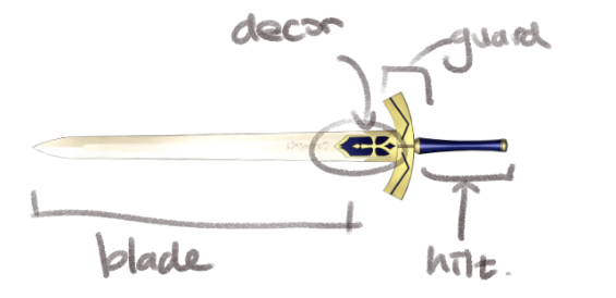

Step 1: Planning
Using the measurements from the Cardboard Excalibur Youtuber and/or the Redditor, you can CAD the parts on Fusion 360. However, if you wish to use your own measurements like I did (optional), take an optional step to measure your miniature replica!
I split the sword into four parts and connected them internally with a wooden dowel (shown above for easier visual understanding):
- Blade
- Hilt
- Guard
- Blade Decoration
The dowel is 1/2in in diameter and I cut mine to 98cm (I purposely made mine slightly shorter than the maximum length of it in case of any complications when assembling, there is slight wiggle room inside the hilt but it is not visible and does not cause any problems).
