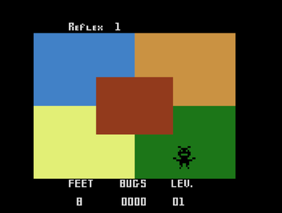

Video Reflex was pretty terrible. The screen showed colored rectangles, and when a bug appeared on one of them, you had to stomp on the corresponding mat button. Either out of bad UI design or for added challenge, the rectangles on the screen are not arranged in anything like the order on the mat itself.

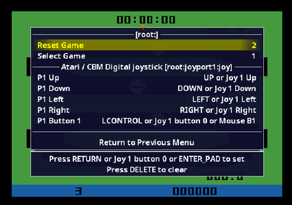

- Press TAB.
- Select INPUT (THIS MACHINE). (E.g., press DOWN and ENTER.)
- Make sure that each of the P1 buttons lists a Joy option. If not, your pad was not recognized. Go back to step 2.
- Select each of the P1 lines, press ENTER, and then step on the DDR pad button you want to go with that.
- If you want, map the RESET button, too.
- Press TAB to get back to the game.
For convenient reference, here are the bindings I suggest:
- P1 Up: DDR pad top-left
- P1 Down: DDR pad top-center
- P1 Left: DDR pad right
- P1 Right: DDR pad top-right
Then press whatever you mapped the RESET button to (MAME default is the 2 keyboard button) and start running on top-left and top-center.
