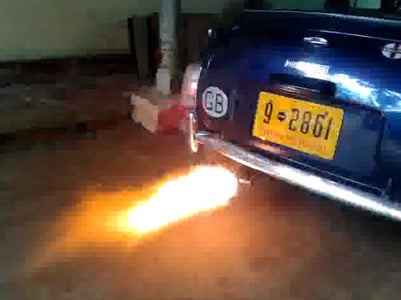

I Just wanted to make a flame through my car exhaust...These happens in modified rides like Mitsubishi evo Subaru and any car with Antilag system. But unfortunately we cannot do with this with our standard car.If we do some modification like antilag system we have to spend expensive money.
So I Made an Exhaust flame thrower kit and it went very success and now you can buy it via ebay or official selling site.Below I mentioned the links for the kits and also the official Facebook fan page for exhaust flame thrower.
What is Exhaust Flame Thrower?

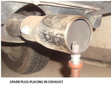

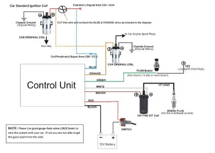

Exhaust Flame Thrower Kits burn your engine's unburnt fuel. The unburnt fuel has been produced by our control module by momentarily interrupting your vehicle’s ignition system. This produces more unburnt fuel through the exhaust. When this happens our spark unit then ignites the fuel producing a 1-8 foot flame from your exhaust.
Check below video of my car fixed with Single Exhaust flame kit!! also 2nd and 3rd are my friends cars.!!

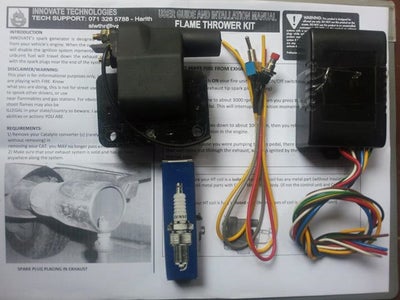

This kit includes everything you need!
-Spark Plug
-Flamethrower Unit
-Spark Plug Wire
-Switch On/Off
-Push button
-Installation Instructions
