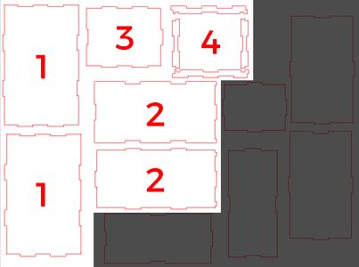

For the outer box, we'll only be using the left half of the first file (Main Organizer.pdf).
Pieces (1) are for the top and bottom of the organizer.
Pieces (2) are for the sides.
Pieces (3) and (4) are for the back and front, respectively.
The pieces are friction fit so just put them together! Be careful not to crack them though, that would be sad. :(
