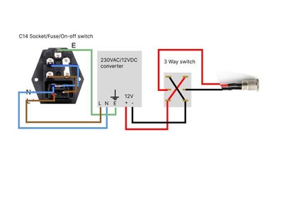

Step 4: Assemble the Base
The base serves multiple functions depending on the configuration. It is rigid and heavy, ensuring stability for all machines. It includes a 230V AC to 12V DC converter to power the linear actuator for the injection and press brake configurations. The base is constructed from bent steel sheets with HPL sides, and the PVC pipe in the center is used for vacuum forming. Assemble the base in the following order.
- Rivit all rivit nuts (11) on the Bottom plate (5).
- Bolt the AC/DC converter (13) to the Bottom plate (5).
- Spotweld the Cap Nuts (2) on the Base plate (1).
- Glue (with pvc glue) the two pvc parts together. (4) + (3).
- Press fit the pvc pipe (4) trough 'kapje front' (6).
- Click the 3 way switch (7) in 'kapje front'(6).
- Bolt C14 chessis socket (10) onto 'kapje back' (9).
- Screw the DC connector onto 'kapje back' (9).
- Connect the wiring (part nr. 4.11), following the wiring diagram from the image above.
- Bolt the top (1) and bottom (5) in place with the m4 bolts (11).

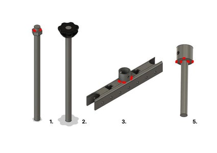

Step 7: A Few Bits of Welding
- Spotweld M10 nut (4.2) to M10 threated rod (1.5, 1.6, 1.7) 2x on a distance of 1 cm from the edge
- Glue 3D printed M10 Nut ring v2 (2.3) all the threated rods from above
- Spotweld piston v3/top part (1.4) to the centre of 'Gelijder v3' (5.3)
- Spotweld piston v3 (1.9) to piston v3/top part (1.4). Use a washer to fill in the gap.

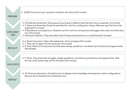

Step 13: Educate
The Experiential Manufacturing Machine can function as a standalone tool or as part of a workshop. In this case, the machine is integrated into a workshop using a productive failure (PF) approach. This approach flips the traditional learning process by beginning with an exploratory problem that students cannot solve, followed by instructions that fills in the missing concepts. This method actively engages students in problem-solving.
The workshop setup, as illustrated in the image above or the attached PDF, utilizes several machines in a classroom with 20 students.
