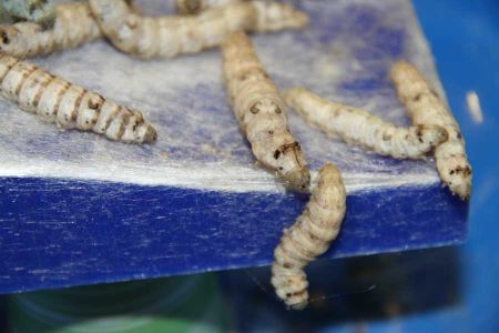

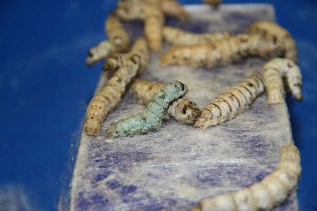

Silkworms naturally create cocoons. But it's also possible for them to spin silk on surfaces.
When given a flat surface, a spinning silkworm deposits silk on the flat surface. The images above demonstrate the concept. The silkworm moves around on the surface, trying to find a corner or large post area to create a cocoon. Given none such areas, the worm continues to spin as it is searches, depositing silk on the surface. (Image credit: Carlos Uribe Gonzalez, Jared Laucks, Markus Kayser).
Tips for spinning silk on surfaces:
- Silkworms prefer spinning silk on natural surfaces. Paper works well. Black paper is nice because it contrasts with the white silk, making the silk easy to see. Glass also works well. Although the silk sticks to the surface, it's easy to remove as a layer.
- It's important to keep the surface on a raised platform. The silkworm will cantilever its body off the edge of the surface and try to reach other surfaces. Maybe you're thinking... can't they see the other surfaces? Silk worms have very bad eyesight; instead of looking, they feel their way around in search of a 3D space.
- Silk worms will occasionally fall off the platform. So a little vigilance is required to keep plopping them back onto the surface if they fall off.
- Non-flat surfaces are totally possible! As can be seen in the images above, the surface geometry effects the silk deposition. For example, the worms are attracted to edges and will deposit more fiber in these regions. The worms also bridge three dimensions areas with silk patterns if the 3D surface is not too high to create a cocoon (for example, small vertical posts or the upturned edges of the maltese cross samples). The array of flat squares with vertical posts (image above) demonstrates this phenomenon. At a critical post height of 2 centimeters, the worms can build a cocoon. Below that height the worms create tent-like geometries.

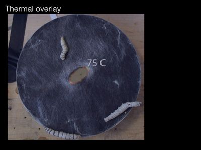

To test this, I hacked together a simple platform (pictured above) to create a temperature gradient. The platform was made of soda-lime glass covered with paper. Glass was selected because it is a mild insulator. A strong insulator, such as silicone and many plastics, would create a very sharp gradient. If the platform were made of a thermal conductor, such as aluminum or other metals, the entire platform would be the same temperature. Other materials with similar thermal conductivities should work as well.
(List: Thermal conductivity of common materials).

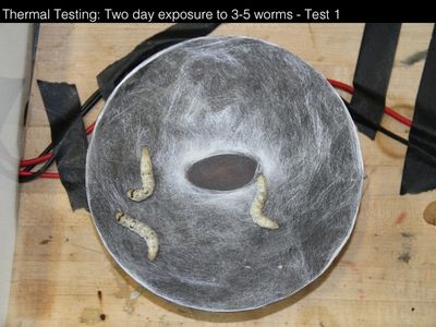

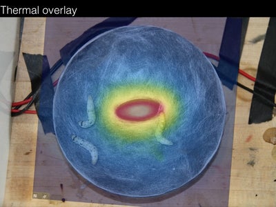

For the heat source, I used a scrap 10 W power resistor. [List of power resistors on digikey that should work] and connected it to a DC power supply. To attach the power resistor to the glass, I waterjetted a press-fit hole into the bottom of the glass and then carefully pressed in the power resistor. This really was overkill. If you're interested in doing this, use a high-temperature adhesive (high conductivity & resistant to heat) where you would simply glue the power resistor to the surface of the glass. Other types of temperature sources should work just as well
Experiment:

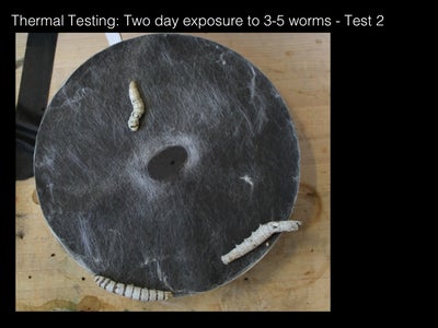

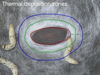

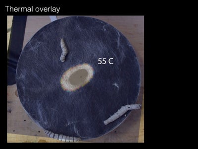

For the actual experiment, I placed 3-5 spinning worms on the surface for two days. I took the temperature of the plate using a FLIR camera. As can be seen in the thermal images, the heat pattern is oval-like due to the rectangular shape of the power resistor. The temperature gradient ranged from a hot core (around 140C) to room temperature.
Results:
The worms deposited silk in greater density near regions close to the heat source - but not too close. The heat appeared to create a sort of "campfire-effect" that attracted worms to warm regions. The surface in these regions - according to the FLIR - was around 40-80 C. The experiment was repeated twice. The room temperature was not controlled. My intuition is that if the room was very warm (perhaps 28-32C or 80 to 90F), then this effect would go away.

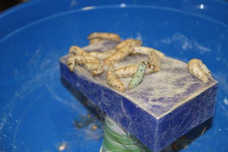

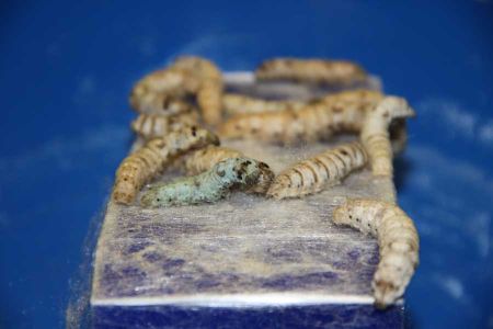

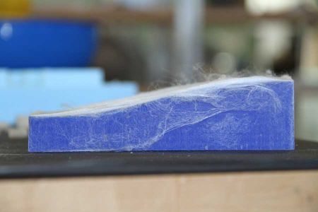

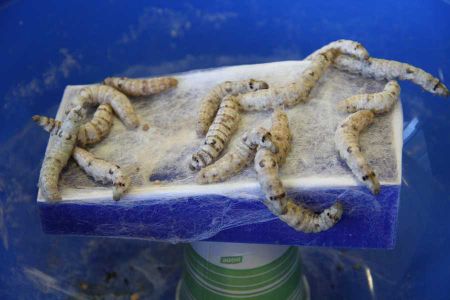

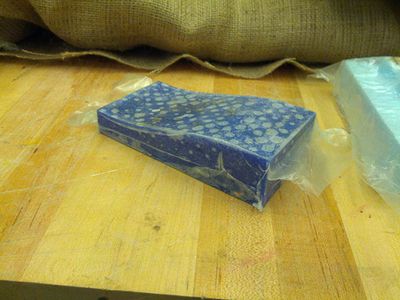

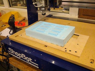

The silkworms need a surface to deposit their silk. I decided to design a simple wave in Rhino and milled a wax surface using the tabletop Shopbot.
Harvesting the silk:
I propped up the wax surface using a paper cup and put them both inside of a large blue bowl. The bowl captured any potential escapees that jumped off the wax surface.
I left the worms on the wax wave for about 2 and a half days. The worms applied more silk to the edges of the wax block.

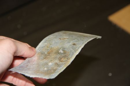

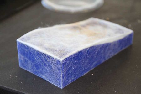

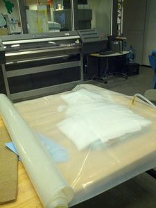

I applied a very small amount of resin on top of the silk fiber layup. (Approximately 10-20 drops) and gently smoothed it around for an even coating. [Entropy Resin Super Sap 100 works well] Then I put the wax, fibers and resin into a vacuum bag, covered with cotton padding and vacuumed the piece overnight.

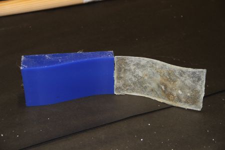

The results can be seen in the images above.
The finished piece was thin and flexible, yet retained the geometry of the wax wave. The edges of the layup were noticeably stronger and stiffer where the silkworms had deposited more fiber.
Overall
Overall the process created a material that was flexible and strong. The piece was noticeably stronger along the edges of the piece where the silkworms deposited more silk. It's unclear how much of the strength and flexibility of the piece came from the resin vs the samples. In a very simple negative control, I made small rectangular pieces of resin, which were brittle and snapped easily. So, the silk did something! But its unclear how the material would perform compare to another natural fiber, such as burlap.
