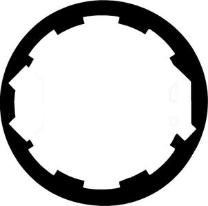

The logo of the rock band AC / DC was taken as a basis. The logo was split into separate elements. Each element according to the results of the work should have its own color. It should be noted that for the correct drawing, the original image must be reflected horizontally.
The original image and each layer separately:
To prevent the image from shifting when changing metal plates, marks were applied to the glass. According to these marks, when the processed glass is displaced, it is placed in its original position.
